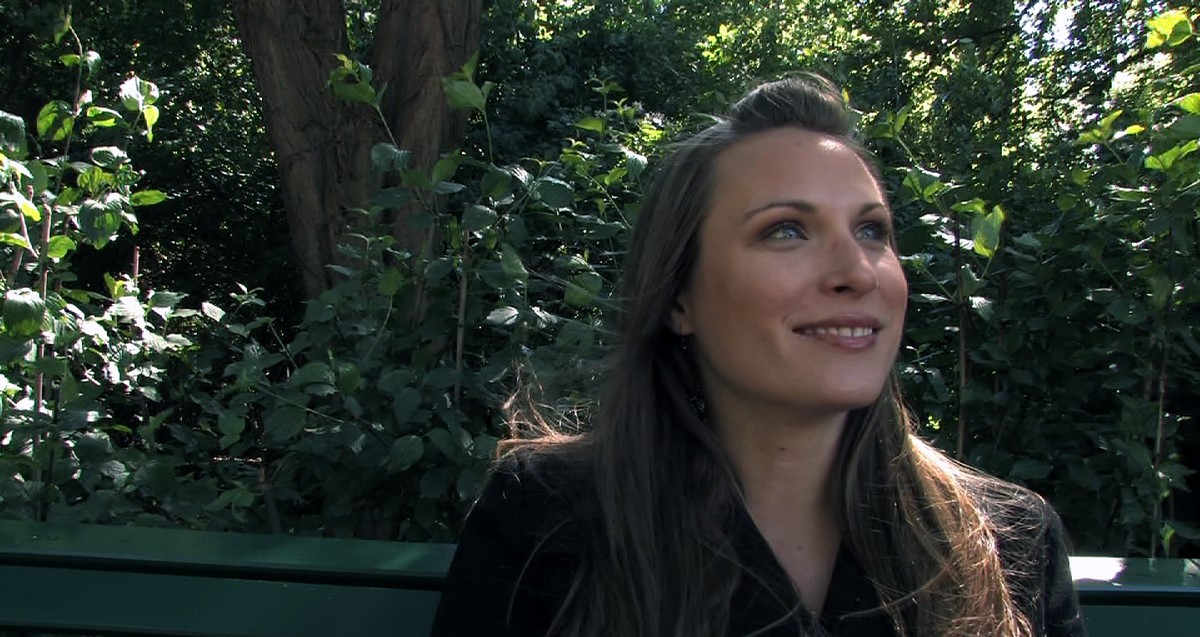

Hi, dont know what kind of noise is that, I try a lot of filter but dont go away..only ezdenoise up to 8 but are too strong and ruined video...
I'm not a pro in video editing, I work for personal use, so maybe I dont put the right filter and value...

Looks like ringing artifacts which got compressed too strong.
Assuming this is a reencode if your source and the source does not have so strong compression artifacts, de-ringing filters might help.
Would need an uncropped sample to suggest anything specific. (upload it somewhere and share a link here or send it to me via pm and I can look at it after work)

Thanks for the reply, here are a shot clip unedited, maybe there are other noise

Had a quick go at it, using aWarpSharp with depth set to 32 and planes set to 'chroma only' helps with the chroma halos.
Either SCUNet (requires torch- or vs-mlrt-addon) or DeblockQED_aWarpSharp-16-onlyChroma-TemporalDegrain2-mlClean-FineDehalo help with the noise.
see: here.
Tweaking the settings and probably using a less compressed source (capturing should always be either without reencoding when capturing streams or lossless) might allow preserving more details.
Problem is, the original source was sharpened (which causes halos and ringing) and overly compressed, which turned the artifacts caused by the sharpening into the mess you have.
Ps.: BasicVSR++ is too aggressive for the whole image.
Thanks for your attemp, now I also think its a bit oversharpened..the first sample with scunet look good, maybe look a bit painted...maybe in some close-up in the face make another effect...

Using aWarpsharp2 with Depth 32 on chroma only and then SCUNet, I get:
Using SCUNet and then aWarpsharp2 with Depth 32 on chroma only, I get:
You could add some sharpening or even try CodeFormer(on some sources CodeFormer will perform well, on others not; CodeFormer requires the torchAddon) or maybe both.
If content seems too flat after denoising, try adding some grain.
