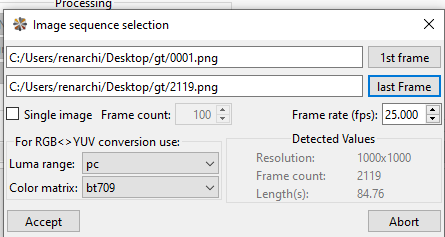

I don't fully understand the issue, but I am inputting 2119 frames (png) with "Image Sequence" for processing. However, it gives 360 frames as output. I've never output in .raw with Image Sequence before, so I have no idea if I'm doing something wrong.Please, read the 'Infos needed to fix&reproduce bugs,..'-sticky before you post about a problem.
Judging by the image, the frame count seems to be fine, and all images are detected.
