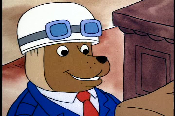

I have some DVDs where they crammed a LOT of episodes on each disk resulting in some serious issues related to video compression.  I usually just leave video as-is, but this is bad enough that I'd like to experiment with some filtering.
Based this image (see the dog's face), would you be so kind as to recommend which filter(s) would give the best chance of improvement?  Is this a problem that requires deblocking?  ...or something else?

Some heavy denoising might also do a fine job, would need a sample of the unprocessed source and some info about your hardware and what os you are using for proper suggestions.

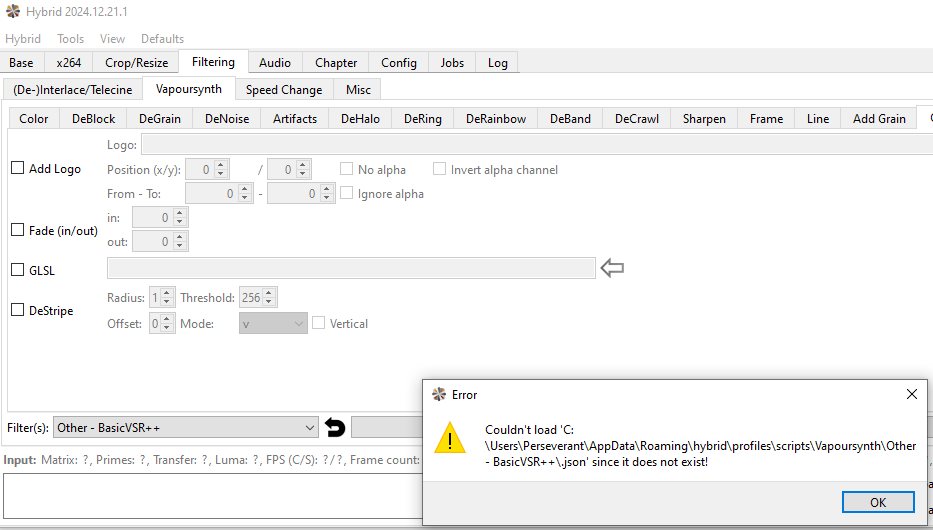

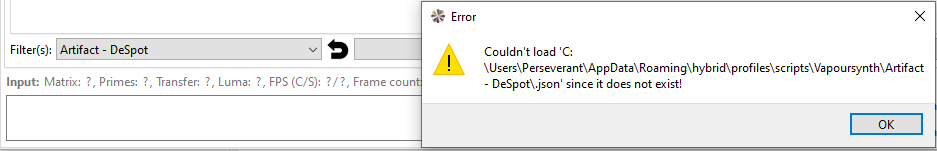

I'm feelin' dumb.  There's probably some basic UI feature I'm missing, or I might be looking in the totally wrong places, but I'm hitting dead-ends, probably because of things implied that I don't know.  I'm on the latest release.  I'm sorry.  Can you provide a little more guidance?  This is the best I could do:

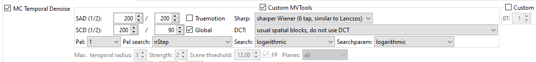

MCTemporalDenoise in Vapoursynth>DeNoise tab (I did not see a "MCTemporalDegrain" option in any of the tabs, or a "very high" selection):
BasicVSR++ in Vapoursynth>Other>Filter drop-down is throwing an error:
EDIT: I found Despot in Vapoursynth>Artifacts as well, so I think I'm good on that one...
Sorry, it's MCTemporalDenoise. For BasicVSR++ the torch addon needs to be installed. Link to the addon is in the download Page.

One final clarification:  What did you mean by "very high" with MCTemporalDenoise?  I want to get the absolute best quality even if it takes longer to encode, but I don't see a quality setting like that and I'm not sure which selections I should change, if any.
