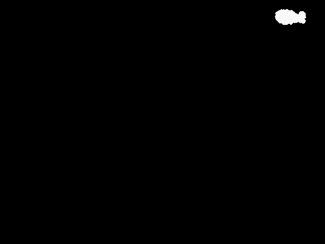

How to create a mask? Extracting one frame out of the video and Highlighting areas which need to be removed as white and rest of the areas as black. right?

Quote: How to create a mask? Extracting one frame out of the video and Highlighting areas which need to be removed as white and rest of the areas as black. right?
Correct, like you wrote. The resolution of the screenshot should be the same as the video at the position where you apply ProPainter.

Using (just ProPainter no cleaning etc. with the attached mask):
clip = ProPainter(clip=clip, img_mask_path="C:/Users/Selur/Desktop/mask.png", length=500, mask_region=(256,256,380,0))

Using the same mask shared by you.

Did you try different settings?
clip = ProPainter(clip=clip, img_mask_path="C:/Users/Selur/Desktop/mask.png", neighbor_length=5, ref_stride=5, mask_region=(256,256,380,0), sc_threshold=0.15)
