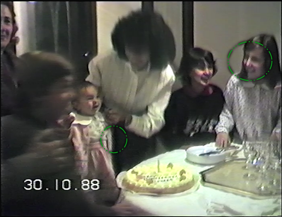

this is what happens on final result using MCdegrainsharp and QTGCM deinterlace.. on the original footage is not too much visible but after the degrain is very very evident.
original footage: https://www.wcn.it/defect.zip
the problem seems related to some sort of fast interference (generated on the TBC) and red seems more influenced from it. the strange thing is that just on this tape is very very evident.
very thnak you for any help!

Looks like some kind of aliasing.
1rst idea try:
1. denoising the separate fields before deinterlacing/ivtc.
2. applying Santiag with increased strength afterward.
will look at it after work.

In your custom section you use:
'denoise','tivtc','antiAliasing' but you don't import the used scripts, or load the required plugins.
No clue why you are using a custom section, to begin with.
The stuff I did in post #3, you can archive by: - loading your source
- enabling and settings 'Filtering->(De-)Interlace/Telecine->Overwrite input scan type to' to 'telecine'
- setting 'Filtering->(De-)Interlace/Telecine->TIVTC Settings->TDecimate->Mode' to '7'
- setting 'Filtering->(De-)Interlace/Telecine->TIVTC Settings->TDecimate->Rate' to '23.976'
- setting 'Filtering->Vapoursynth->Misc->Script->Filter interlace handling' to 'separate fields'
- enabling 'Filtering->Vapoursynth->DeNoise->MC Temporal Denoise'
- setting 'Filtering->Vapoursynth->DeNoise->MC Temporal Denoise->Settings' to 'very high' (optionall increasing ncpu to 10)
- switching to 'Filtering->Vapoursynth->Misc->Filter Order/Queue' and moving 'MCTemporalDenois' above 'Deinterlace'
- enabling 'Filtering->Vapoursynth->Line->AntiAliasing->Santiag'
- setting 'Filtering->Vapoursynth->Line->AntiAliasing->Santiag->strength->h&v' both to '3 (optionally enabling 'OpenCL')
For me, the Vapoursynth Script Preview then shows:

In theory, you could use a custom section, but when using a custom section you are responsible to load all dependencies&co.
Posts: 148
Threads: 34
Joined: May 2023
very thank you for the help!
