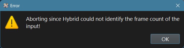

loading some files in hybrid will fail because of a missing frame count (see image)
is there a way to make ffmpeg count the frames on input if that piece of info is missing?

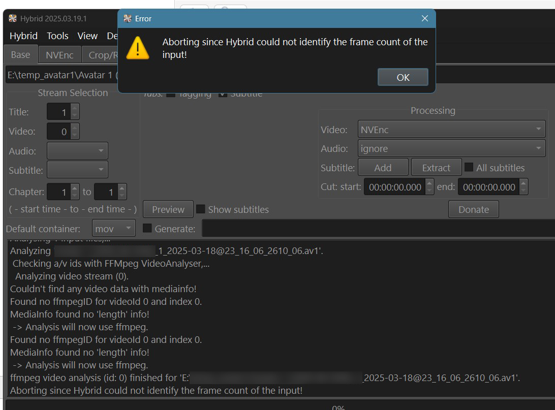

there you go
Uploaded a new dev, try that one.
