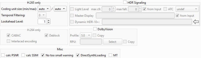

I think that a better option for Hybrid is to use the x264 and 265 mod versions proposed by Patman86 or DJATOM.
These versions are able to read directly the avs/vpy scripts like NVEnc and so you could implement the same direct synth load option already available in Nvenc.
[Image: attachment.php?aid=3143]
P.S.
I noted that StaxRip is using by default the direct synth loading if the selected encoder is supporting it.
