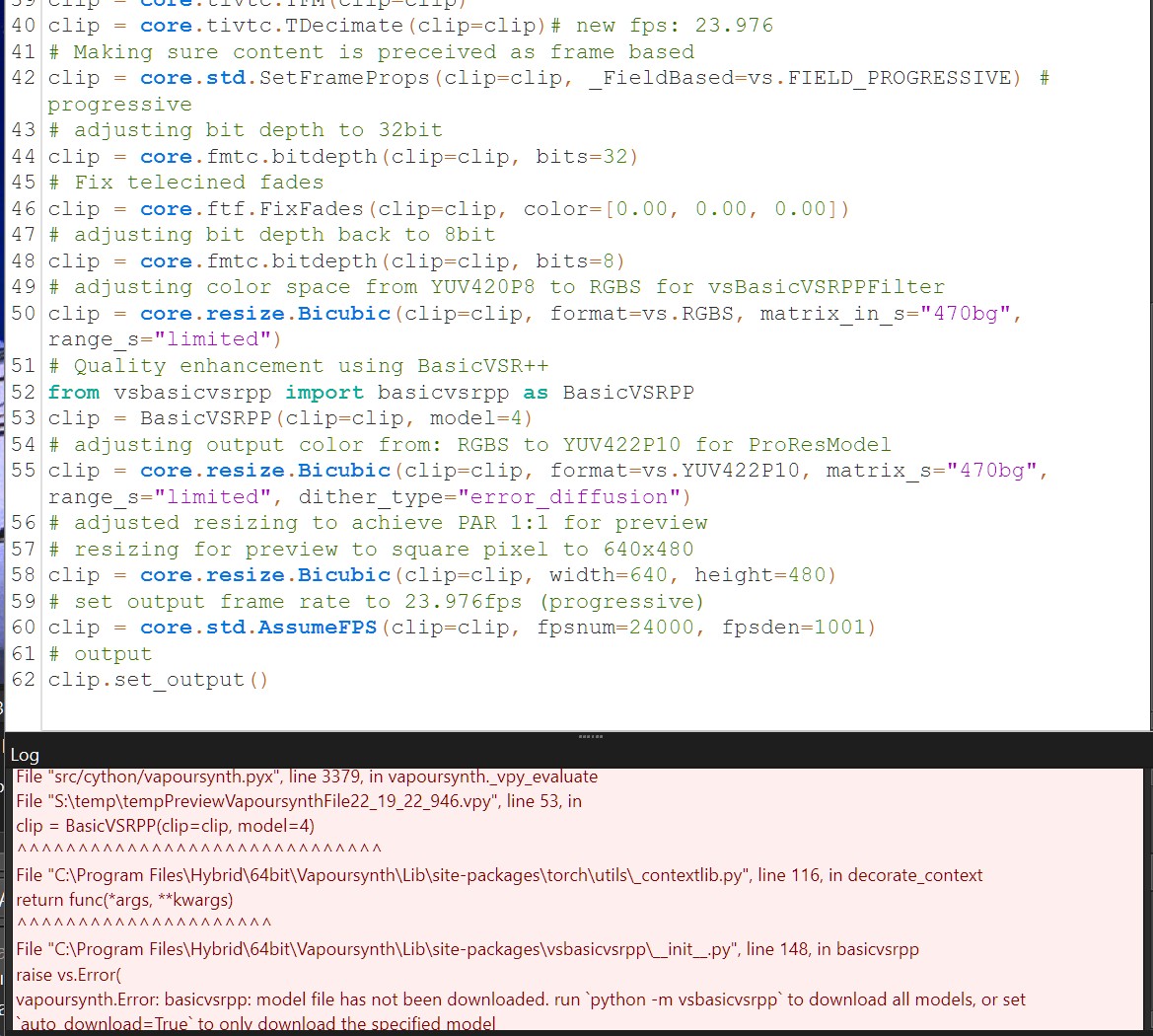

Reproduce:
Activate BasicVSR filter, on preview throws:
"Explicitly instantiated a Cache. This is no longer possible and the original clip has been passed through instead."
in addition, there seems to be a problem with the availability of the model files?
i have newest hybrid + addons installed.

BasicVSR++ is not the same as BasicVSR.
Quote: Explicitly instantiated a Cache. This is no longer possible and the original clip has been passed through instead.
Isn't caused by BasicVSR++, but TIVTC (more precise TFM).
Quote: in addition, there seems to be a problem with the availability of the model files?
Are you sure you downloaded and extracted everything properly?

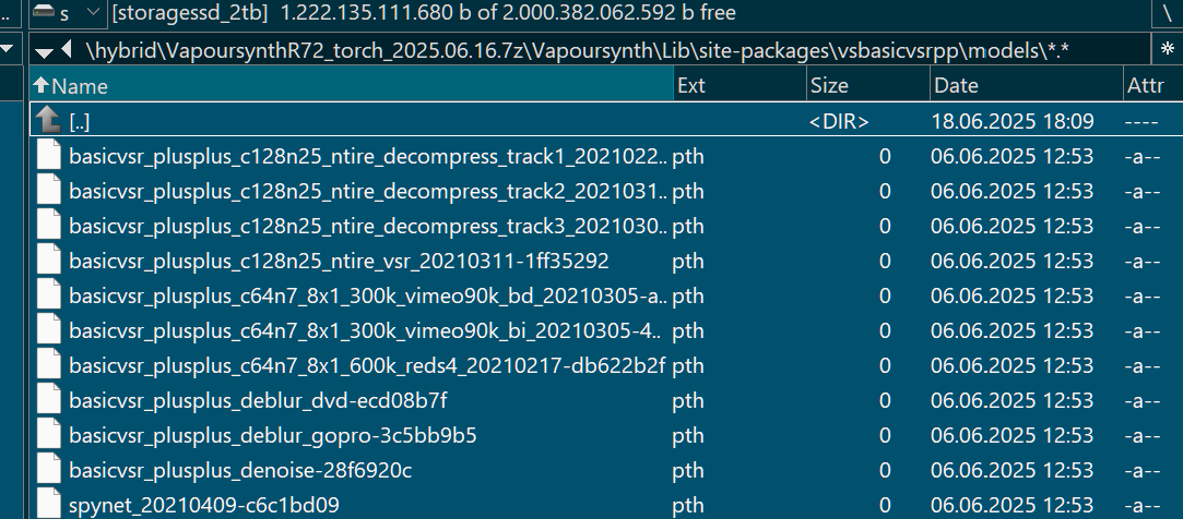

checked the downloaded archive.. that should be the explanation?

Posts: 13.362
Threads: 76
Those seem to be the files I listed, that I got here. So no, that does not seem to explain the crash on your end.

oh ok i thought the 0 byte filesize was the problem
Posts: 13.362
Threads: 76
Ahh,.. I totally overlooked that.
-> will fix
(you can also call: "python -m vsbasicvsrpp" inside a terminal in the Vapoursynth folder)

Uploading a new torch addon which includes the files,.. should be up in ~1hour.

(the manual download worked, too btw)
