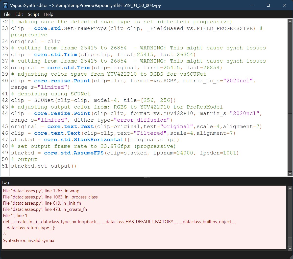

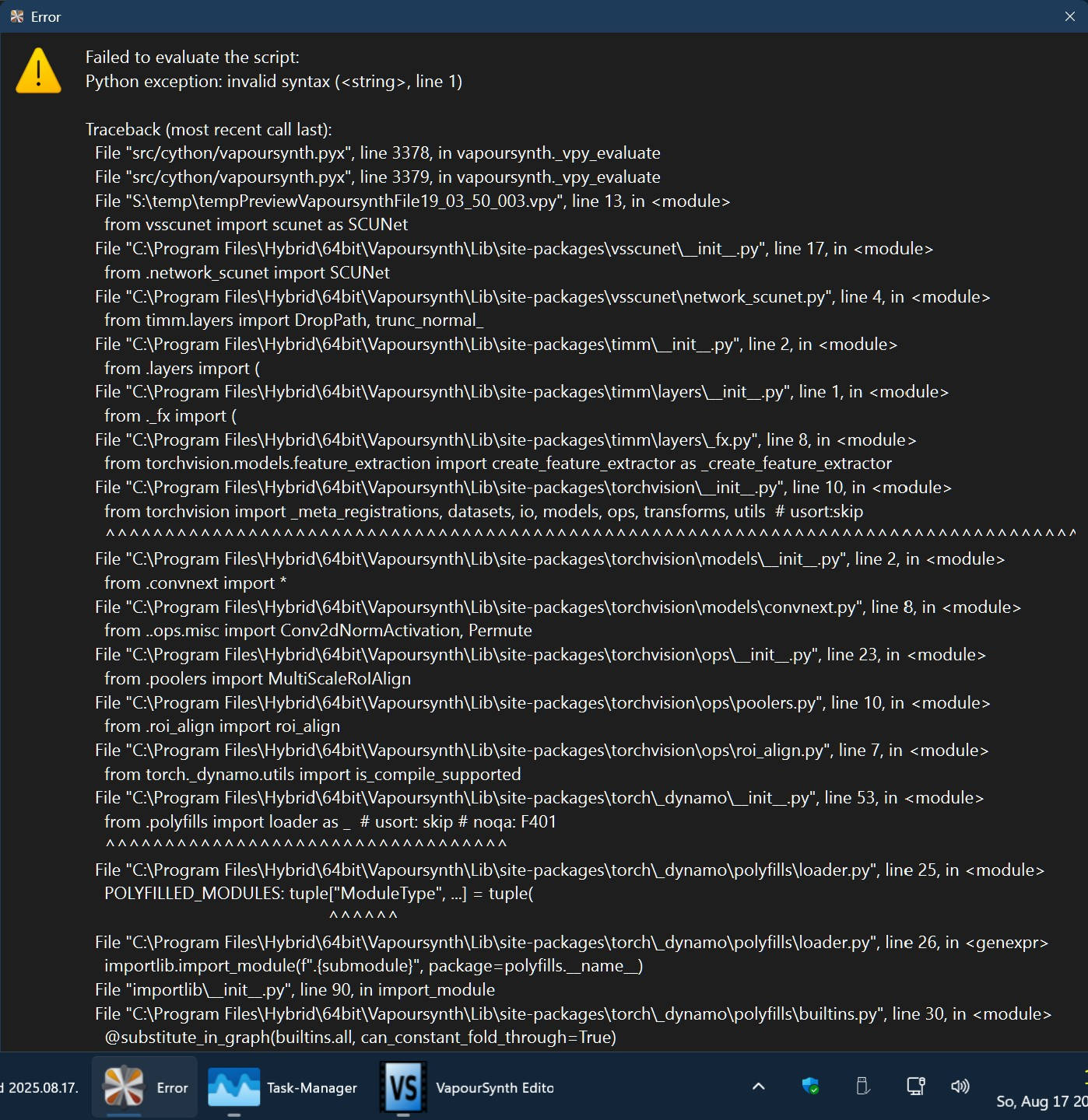

In my case it never worked, I just get a black screen after the .engine finishes compiling (3090).
I'm using 2025.07.27.1 and it didn't work with the May version either (same behavior).

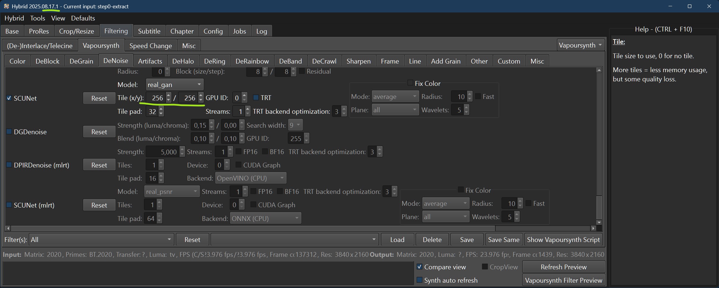

=> Uploaded a new dev version where a FP16 checkbox got added to SCUNet. (when enabled Hybrid will feed SCUNet RGBH otherwise RGBS)
