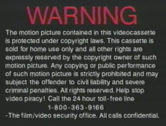

I have a digitized VHS (no access to the original tape) file where it looks like the field heads wobble slightly (vertically) independent of each other. So even after deinterlacing with QTGMC there is some combing or echo (I'm not sure of the right way to describe this) that can last several seconds before aligning again and looking correct. Is there any hope to fix/restore this?

Looking at the 30sec sample:
Try Filtering->Vapoursynth->Frames->Stabilize->ReduceFlicker, it will at least stabilize the video.
Text will still be messed up, since the fields are already broken.
![[Image: grafik.png]](https://i.ibb.co/RwCFyQn/grafik.png)
Looking at the 2min sample, I would also Crop and add Filtering->Vapoursynth->Frames->Stabilize->Stab and probably Filtering->Vapoursynth->Artifacts->SpotLess.
