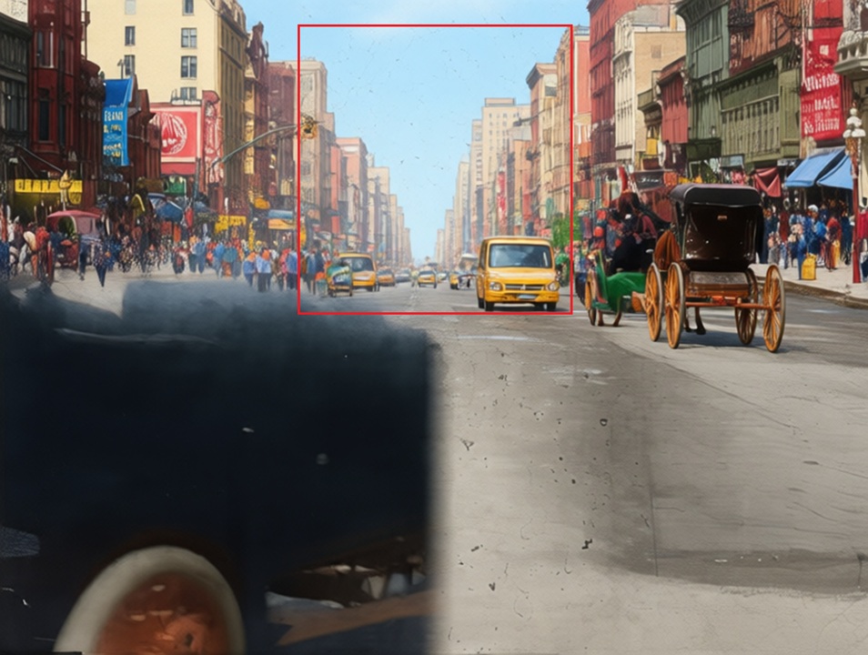

  In the frames colorized with the old version of ditserverrpc there are artifacts (see image below)
  [Image: attachment.php?aid=3625]
  The new colorized frames, don't have artifacts, but are almost in B&W.
   At the following link you can find my results
   https://gofile.io/d/vRABBs
   As you will see there are no artifacts and the colors are more stable.

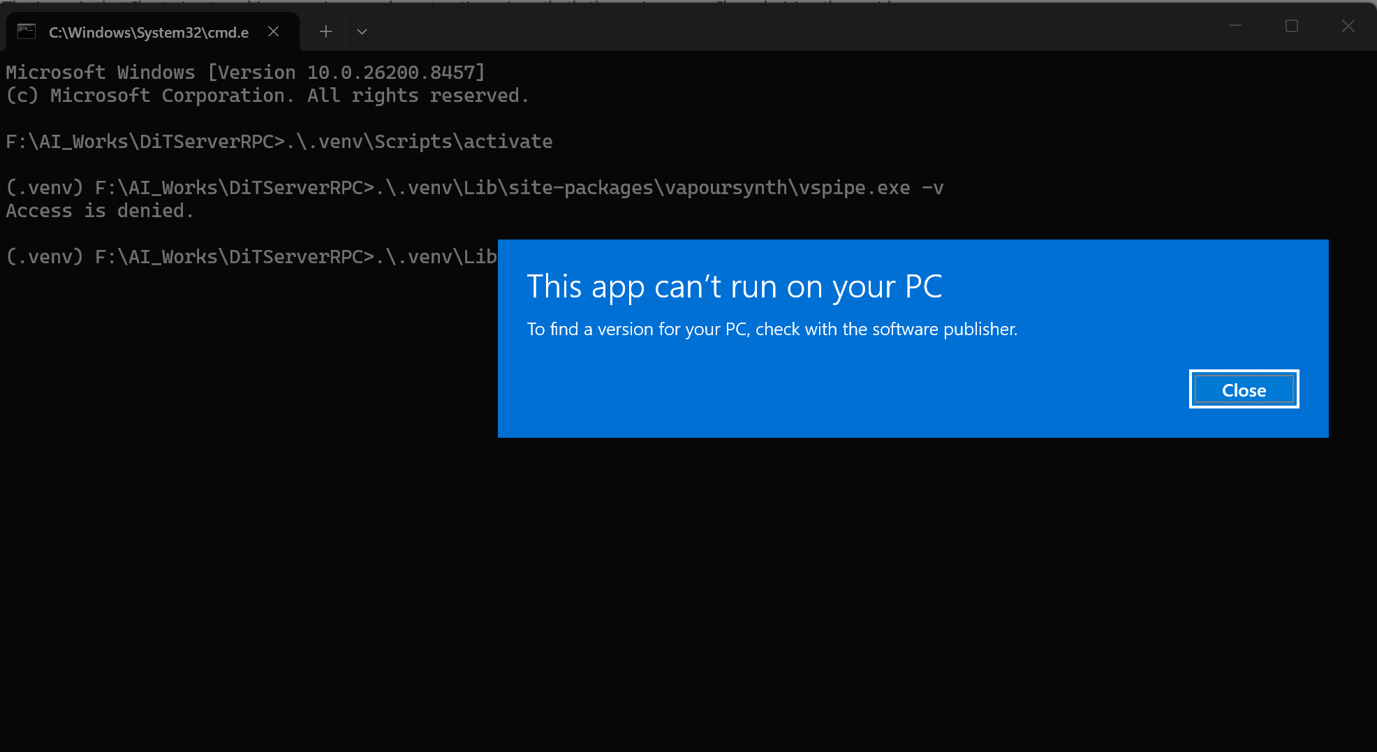

F:\AI_Works\DiTServerRPC>.\.venv\Scripts\activate (.venv) F:\AI_Works\DiTServerRPC>.\.venv\Lib\site-packages\vapoursynth\vspipe.exe -v
and let me know your output.
#89
(09.06.2026, 19:36)Dan64 Wrote: Hi safshe,
  your configuration is Ok.
  Try to run the following command
Please see the attached image.

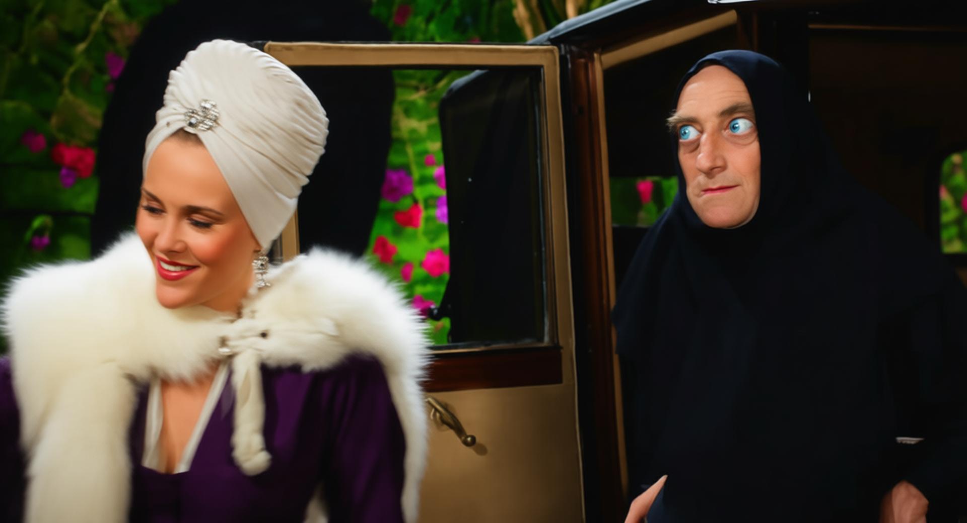

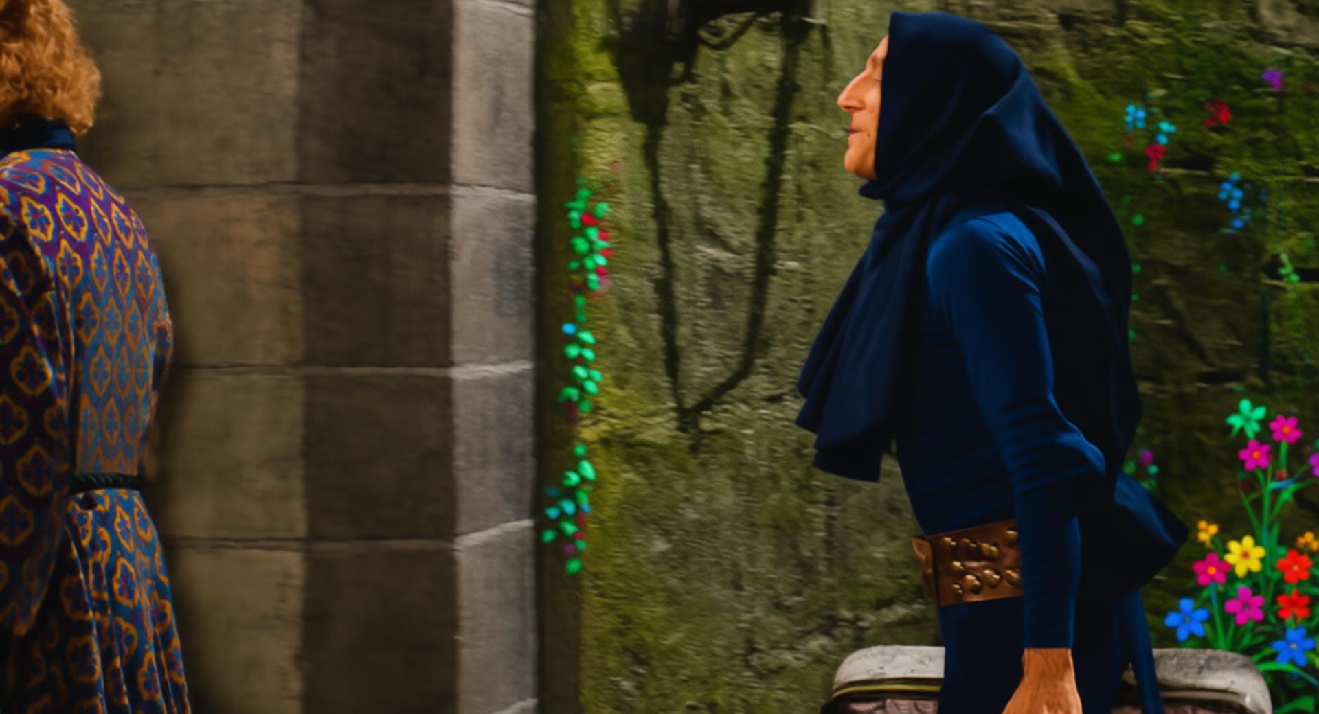

The problem is that if you ask to Qwen to improve the colors is some case it can add artifacts, for example this prompt: " "Colorize this black and white photo with realistic, vibrant colors while preserving skin tones. Strictly preserve all shapes, edges and background details." can produce images like this
[Image: attachment.php?aid=3629]
or this
[Image: attachment.php?aid=3630]
where the background is totally invented.
My prompt will provide more conservative colors, but will force Qwen to provide more consistent colors. You can try to experiment different prompts, but the risk of obtain artifacts is very high.

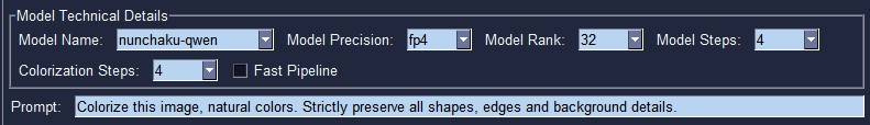

If you want to try to improve the quality try these settings:
[Image: attachment.php?aid=3631]
if you have a RTX50 GPU, run the server in fp4 mode because the fp4 quantization is better and should reduce the risk of artifacts.
