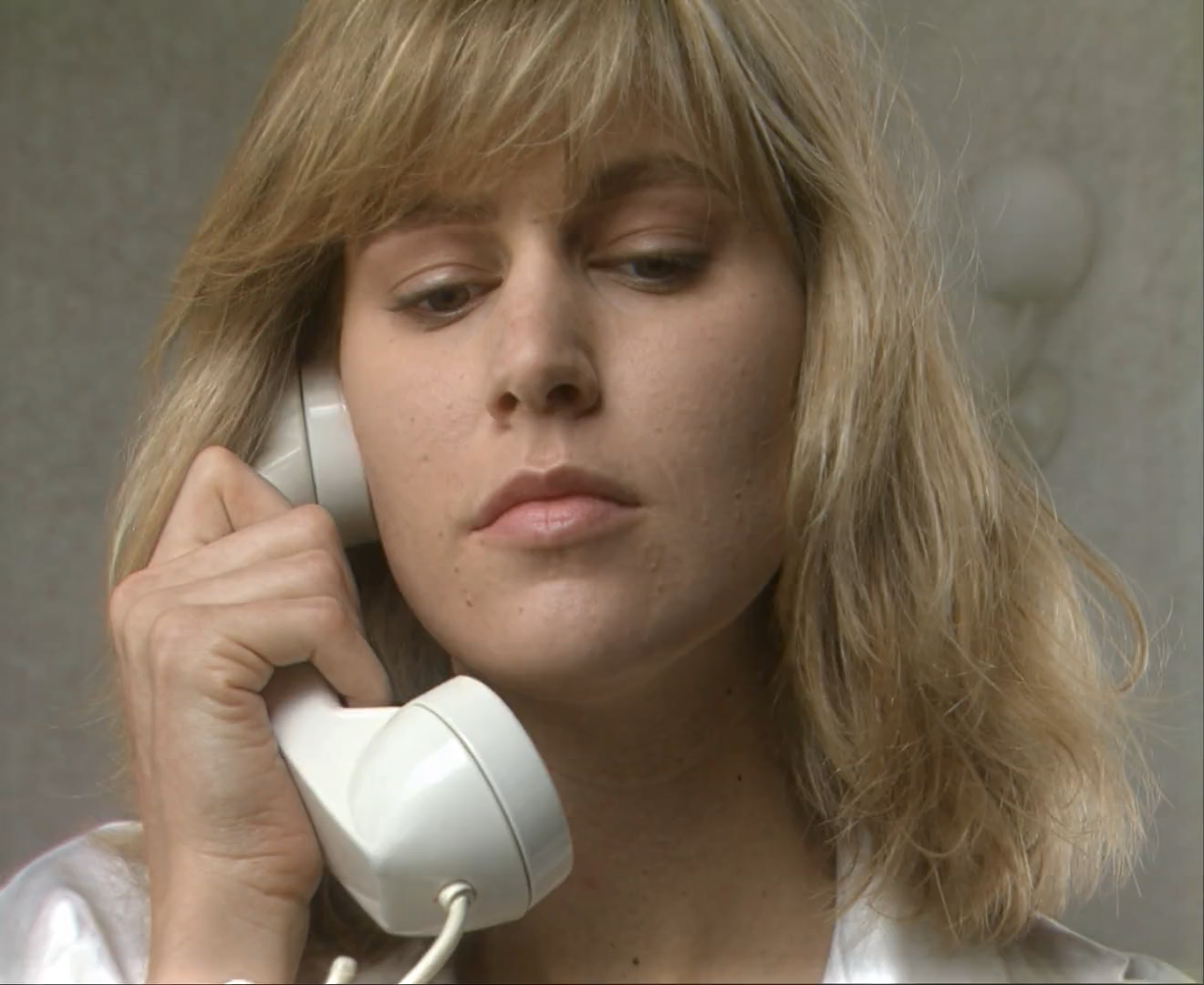

I tried the workflow SeedVR2 1080p-template available in ComfyUI (see attachment).
On my RTX5070Ti it was able to resize a small clip of size 640x504 to 1370x1080 at a speed of about 2.0 fps, using only the 16GB of VRAM (shared VRAM was not used).
Not too bad for a DiT model, but still slow.
.zip   SeedVR2_HD_video_upscale2.zip (Size: 1.015,7 KB / Downloads: 96)
Here a comparison between SeedVR2, Lancozs, RealEsrgasn_x2plus and BasicVSR++
https://imgsli.com/NDQ2Nzk1/2/1
SeedVR2 seems to provide sharper images respect to the other upscalers (I was unable to get "x4 ESRGAN" working on my side).
Quote:I was unable to get "x4 ESRGAN" working on my side
Strange works fine here (in Hybrid).

I think 'sharper' is the wrong term.
To me SeedVR2 does really sharpen more, but does add (invent) more details.
Does anyone know how to change the video encoding settings in ComfyUI ? (instead of crf23 I'd like to use lossless encoding 4:4:4)
In this case RealESRGAN x4 to me seems better than SeedVSR2: https://imgsli.com/NDQ2ODk0
Are you sure that you posted the correct SeedVSR2.png picture ?
Yeah, pretty sure. (deleted the file but can re-create it later and check again)
Here's how the 1320x1080 version of suzie using seedvr2 looks like:
also checked the other version and the uploaded view is correct.
