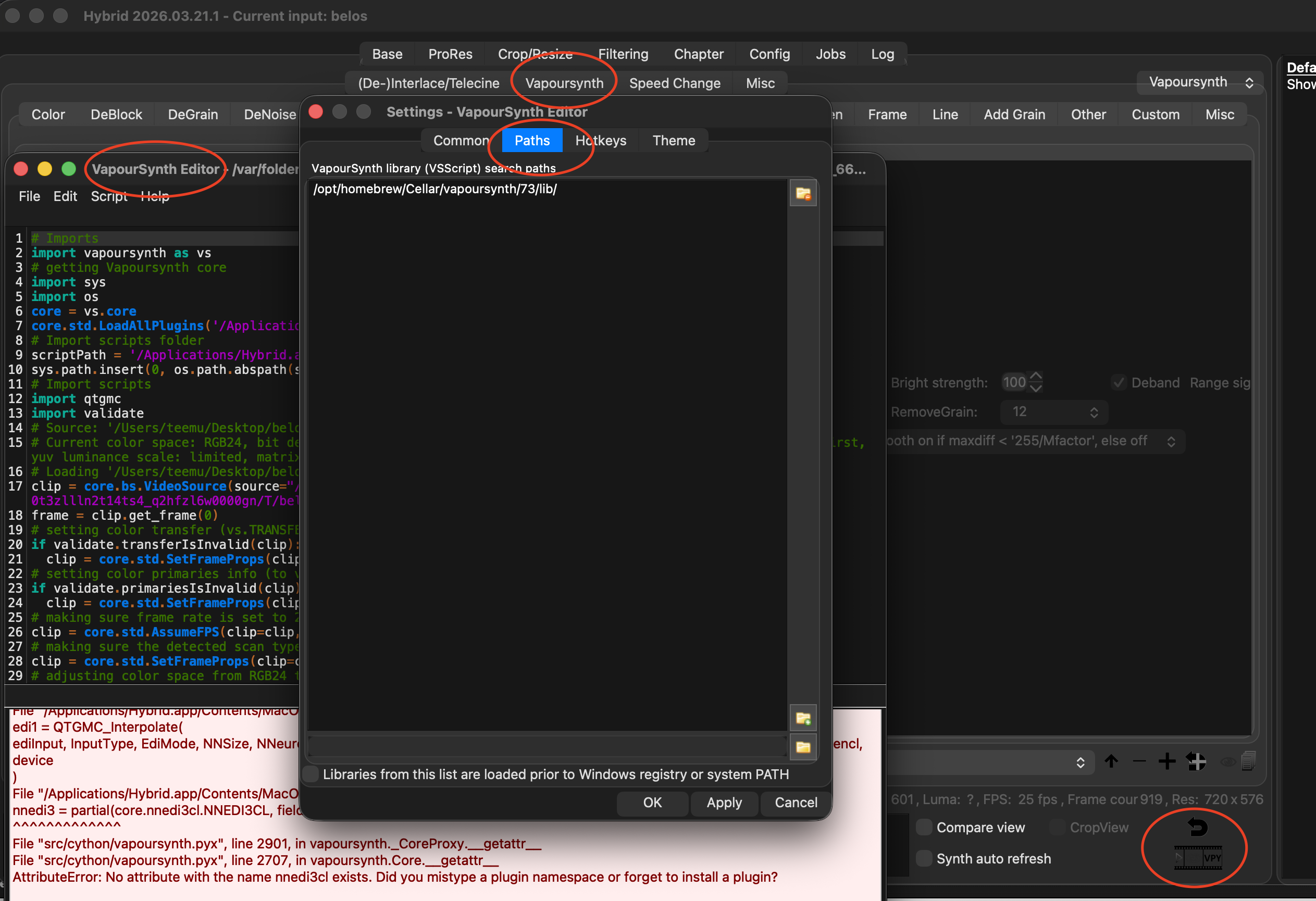

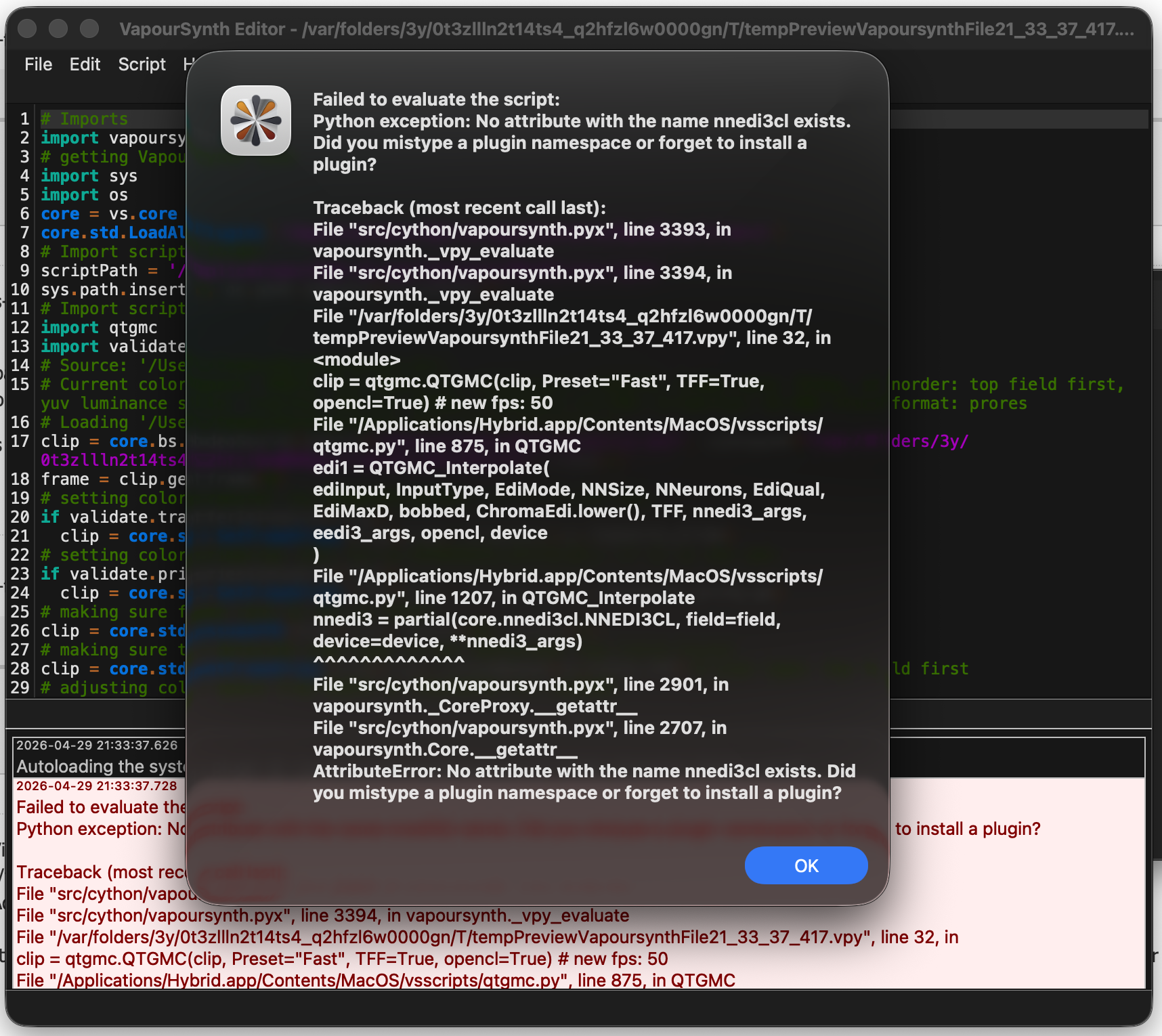

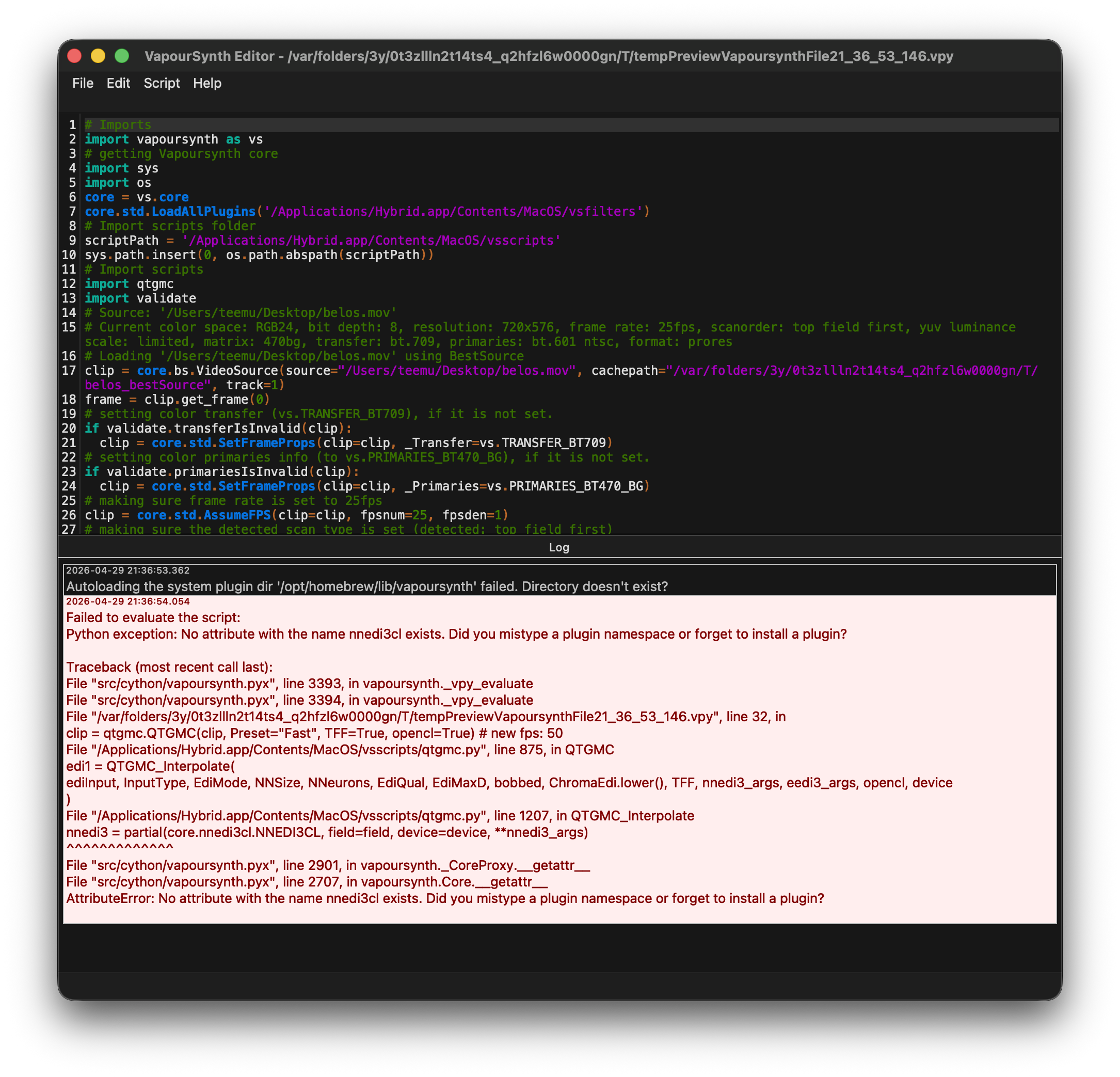

I did a completely clean MacOS Tahoe installation on a UTM virtual machine and downloaded the latest Hybrid_2026_04_29.zip
version from the experimental folder at
https://drive.google.com/drive/folders/1...drive_link.
Hybrid seems to crash in the same way.

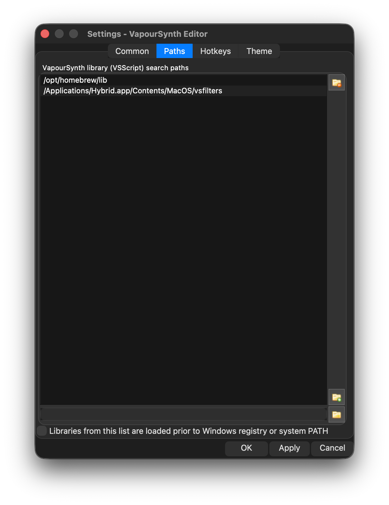

- I have made sure that the paths are set in the vsViewer and Hybrid app, as you have previously mentioned in this thread.
- I also made a short screen recording of this link showing how the problem occurs.
- Additionally attached is a debug log generated from the actions performed during the video.

uploaded a new dev, try whether that one helps
Also, you really should change your temp path.

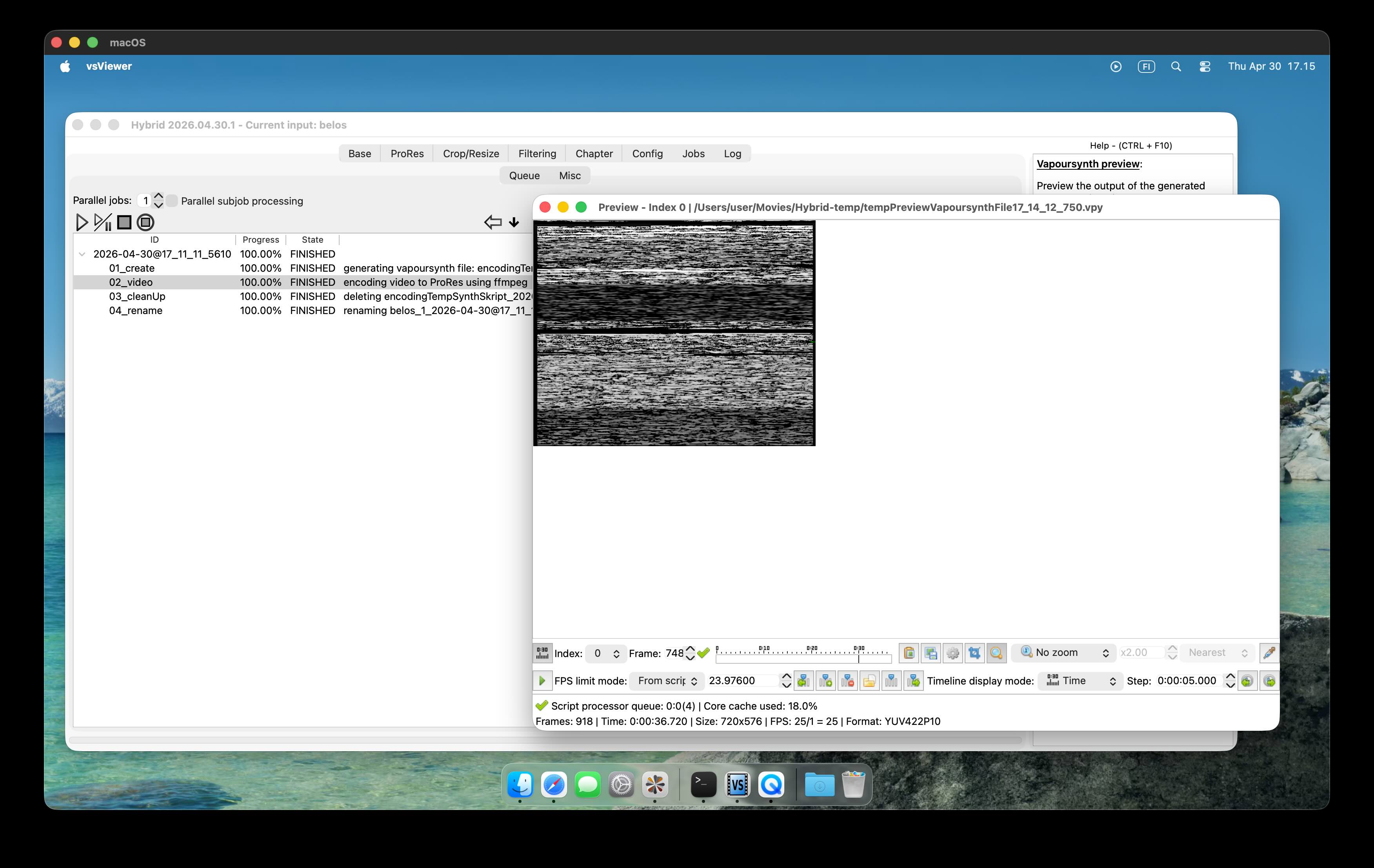

Success! It looks like now the preview and deinterlace jobs are working!
I'll continue testing.
A big thank you to you (and I donated!), it's a revolutionary thing for me that I can easily work with
QTGMC deinterlace on Apple Silicon Mac through an easy-to-use UI.
Attached is a debug log of the current Hybrid app 2026.04.30.1 state, following a basic QTGMC deinterlace job.
[attachment=3585]
