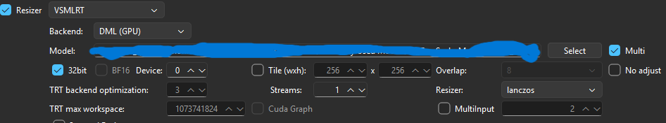

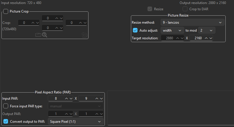

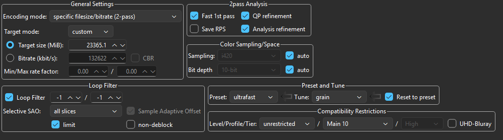

I'm also having this issue with any codec, it caps out at about 00.70 fps when a few weeks ago I was getting almost 2 fps. Same settings and everything.
Ryzen 9 9900X3D + RX 9070 XT 16 GB Video Card. I reinstalled the app and it did nothing. I even reinstalled Windows. Did nothing. Attatched are the settings (dual fp32 onnx models). Any help would be appreciated. Smile
Without a debug output or a way to reproduce this, my guess is that it is related to some changed drivers or the vs-mlrt support for them.
Does it differ between using the latest release with the matching vs-mlrt and the dev with the matiching vs-mlrt?
There doesn't seem to be a difference between using the dev version of Hybrid or vsmlrt.
Okay, so it isn't something that changed with the latest dev or vs-mlrt.
Is the speed normal without vsmlrt? Just to be sure the issue is with vs-mlrt and not something like QTGMC or the x264 preset selected, but not applied.
vs-mlrt releases do not mention anything that DML might be slower in newer versions.
Another idea: check that your antivirus solution, has the temp/output/input/engine folder as exceptions listed to now scan, otherwise some it might slow things down.
