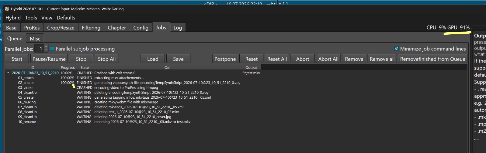

Reproduce:
Load MP4
Scenario1:
 - VS/Deint/qtgmc
 - Preset Custom with EdiExt MFDIN(old)
 - Queue and Start: CRASH
.rar   HybridDebugOutput_crash1.rar (Size: 36,43 KB / Downloads: 9)
Scenario2:
 - VS/Deint/qtgmc
 - Preset Custom with EdiExt MFDIN(old)-TRT
.rar   HybridDebugOutput_crash2.rar (Size: 26,93 KB / Downloads: 9)
additional phenomenon: vspipe keeps vram full and keeping gpu load high despite queue having crashed

no, preview doesn't work either.
(it's a bit strange since i used it successfully in the past.)

this used to be functional in the past.
now the job crashes, but the gpu starts working at 90%+
.rar   HybridDebugOutput.rar (Size: 42,96 KB / Downloads: 1)
