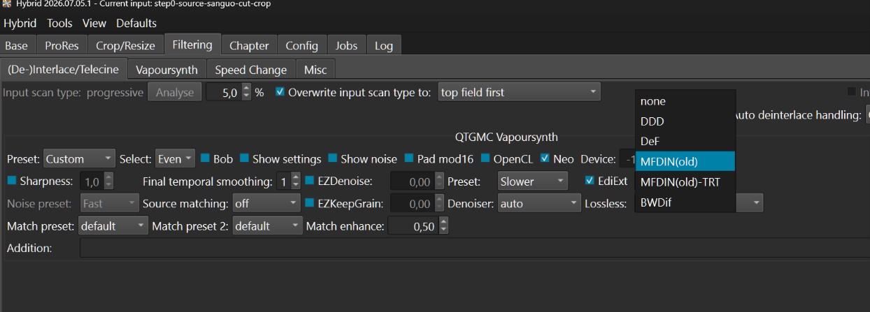

Reproduce:
Load MP4
Scenario1:
 - VS/Deint/qtgmc
 - Preset Custom with EdiExt MFDIN(old)

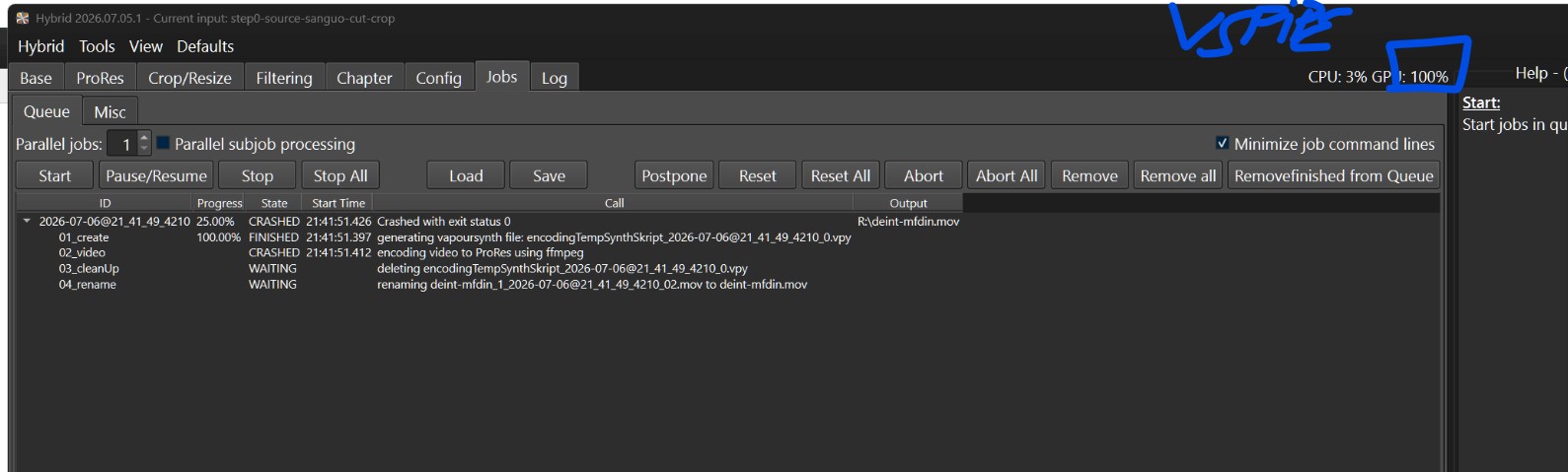

 - Queue and Start: CRASH [attachment=3683]
Scenario2:
 - VS/Deint/qtgmc
 - Preset Custom with EdiExt MFDIN(old)-TRT
 - Queue and Start: CRASH [attachment=3684]
additional phenomenon: vspipe keeps vram full and keeping gpu load high despite queue having crashed

now the job crashes, but the gpu starts working at 90%+

Sidenote: Why are you overwriting the scanorder to BFF ? Looking at the clip it seems to be TFF encoded progressively.
