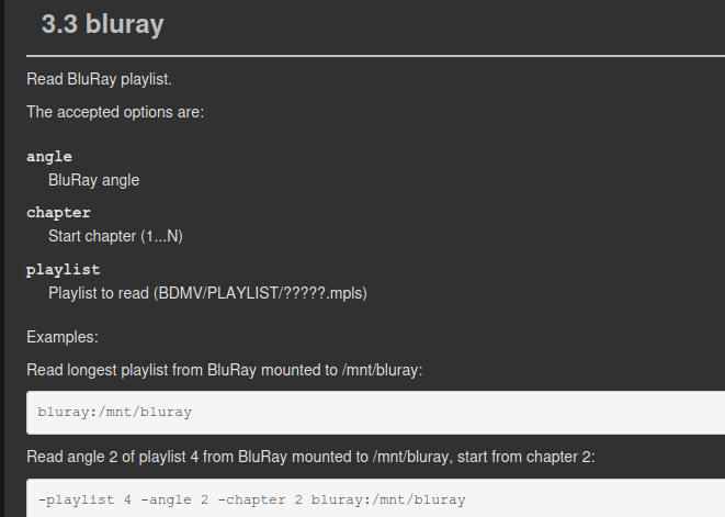

I came across this section in the official FFmpeg documentation:
https://ffmpeg.org/ffmpeg-protocols.html#bluray
It seems to support the observation that the playlist option needs to be specified before the input.
Maybe this is relevant to the issue.

I can confirm the problem with the current order ffmpeg ignores -playlist and falls back to its own pick (the longest title).
=> will fix and report back when a new dev is uploaded
Uploaded the new dev to my GoogleDrive and Mediafire (https://www.mediafire.com/file/6i49yhelw...Image/file) which should fix this.
