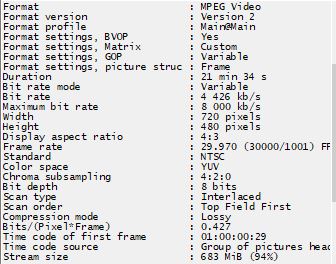

I have some NTSC DVDs with cartoons, that are either mixed or progressive. I dont want to change frame rate or resolution, I just want to reproduce the motion the way it is in the original file, thats where I'm failing hard.
Snapshot with properties from mplayer classic attached. Can also share the sample if you wanna give it a spin.

Without changing fps trying to handle mixed content, I would either simply throw QTGMC at it or keep the content interlaced.
Best ask over at videohelp.com and post a sample. To do this really properly you will probably have to learn a bit about deinterlacing and either Vapoursynth or Avisynth.
So don't expect this to be properly solved fast.
Also keeping the motion data of interlaced data an staying at the same frame rate isn't normally possible. Smile
You would have to double the frame rate to save all motion data.
