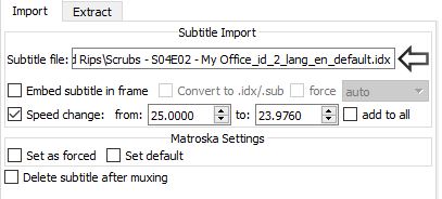

Thanks again, tried today with a fresh install of the dev version and the job successfully finishes and an output file is created with no crash. Unfortunately the stretch doesn't appear to have applied as the subtitles move further out of sync the further you move through the video.
I've attached a screengrab of the settings in the subtitle tab + latest debug log.
#13
Settings seem to be fine.
When stretching idx/sub-subtile Hybrid only takes the idx files and copies it's content and adjusts the time codes, in your case by a factor of 25/23.976=1.0240.., saves a new subtitle file and copies the sub file.

I see that sox uses a factor of 0.95904000 (23.976/25) instead of 1.0240.. (25/23.976) that the subtitle stretching is using. So either one of them seems to be mixed up.
Is it only the subtitles or does the audio also go out-of-synch with the video?
If one of them is correct I can adjust the other to use the same stretch factor. Smile

The audio is perfect, confirming it is only the subtitles that go out of sync.
#15
I'll make a version where the stretch of the subtitle is inverted and send it to you in a few minutes for testing. Smile

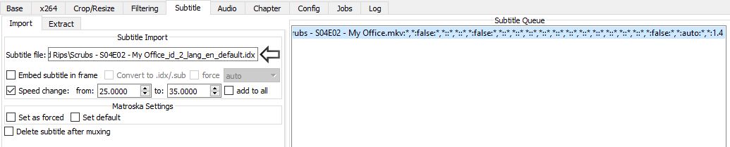

I was playing around with the inverted Dev version and tried a few really far out factors to see what would happen and i've noticed it doesn't actually seem to be making any difference to the subtitle timings...
eg running it at 25.00 to 2.3976 (deliberately moving decimal point) didn't actually change the subtitle timing.
this example was 25.00 to 35.00 with no change as well (done after debug was attached)
Debug is also attached
#17
Just changing the value does not change the subtitle queue entry, you have to add a new entry. Wink
uploading a new version for testing atm. will send you a pm
#18
(25.11.2018, 09:29)Selur Wrote: Just changing the value does not change the subtitle queue entry, you have to add a new entry. Wink
That one did the trick, everything syncing 100% now!.
