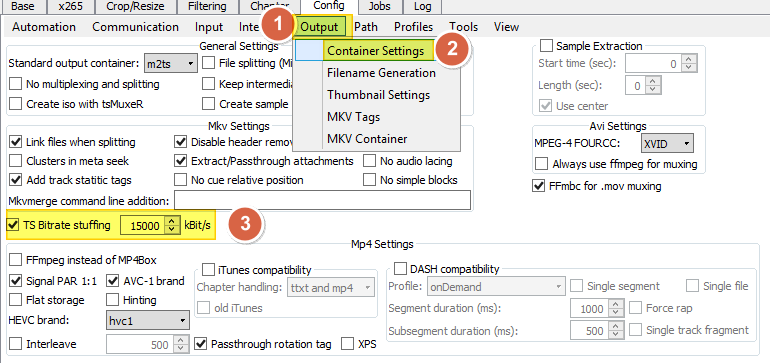

I just found it
Config, Output, Container Settings then TS Bitrate stuffing. (illustration included)

I just found it
Anyway, I found out that it does not work at all...... Confused
Well, it says it is experimental.....hope it would work though. That is what I need.
