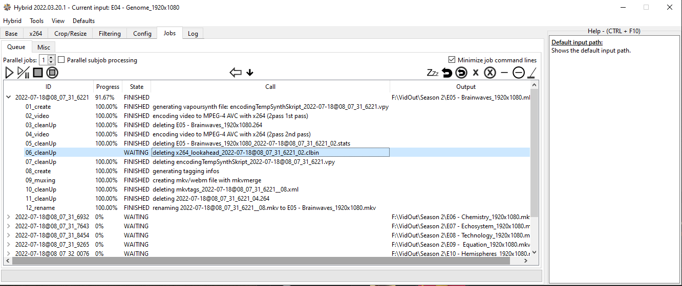

Lately, I been doing batch encodes, but, I have run into a bit of a problem.
After each job in the queue, the queue would just stop.
With the current "finished" but not deleting a file, thus, not reaching 100%. (Only up to 83 and something %)
The final encode is even muxed, but, the job is stuck.
I have to manually clean (using the "broom" icon) for it to continue to the next job.

Okay, problem seems to be that Hybrid expects:
Code:
"C:\Users\SkyNET\AppData\Local\Temp\x264_lookahead_2022-07-18@08_07_31_6932_02.clbin"
to be created by the x264 encoding call:
Code:
x264 --preset veryslow --pass 2 --bitrate 8000 --profile high422 --level 4.1 --ref 3 --sync-lookahead 18 --psy-rd 1.00:0.15 --vbv-maxrate 50000 --vbv-bufsize 187500 --deadzone-inter 6 --deadzone-intra 6 --sar 1:1 --deblock -1:-1 --non-deterministic --range tv --colorprim bt709 --transfer bt709 --colormatrix bt709 --stats "C:\Users\SkyNET\AppData\Local\Temp\E06 - Chemistry_1920x1080_2022-07-18@08_07_31_6932_02.stats" --demuxer y4m --input-range tv --fps 30/1 --output-csp i422 --opencl --opencl-device 1 --opencl-clbin "C:\Users\SkyNET\AppData\Local\Temp\x264_lookahead_2022-07-18@08_07_31_6932_02.clbin" --output-depth 10 --output "C:\Users\SkyNET\AppData\Local\Temp\2022-07-18@08_07_31_6932_04.264" -
Sadly your debug output only starts in the middle of the first of 2passes of the encoding.
No job creation etc. Sad
The surprising thing is that, I would have expected the second pass to fail if the clbin file did not exist.

Okay, I found the issue:
Code:
x264 [warning]: OpenCL: not compiled with OpenCL support, disabling
Normally Hybrid should disable the option if this is the case.
