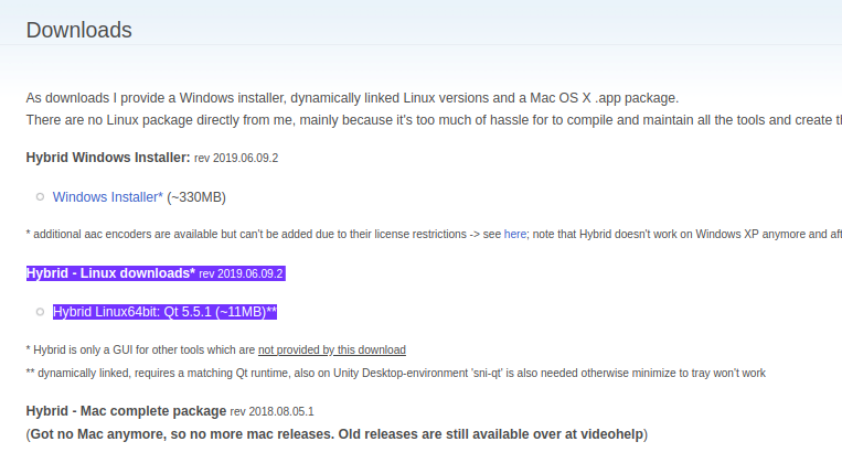

The download on the download page is a binary only.
You need to 'sudo chmod a+x Hybrid' to make it executable.
You would also need to install all the dependencies Hybrid requires.

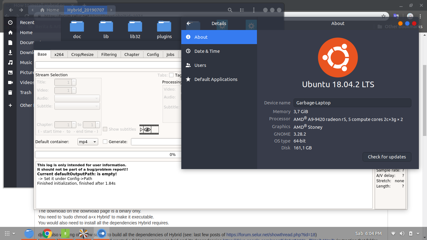

Owhhh... Okay
Thanks!    Big Grin
(13.07.2019, 05:59)Selur Wrote: I ran an older version of the script and created a folder containing Hybrid and it's dependencies https://drive.google.com/open?id=1ptNzWr...fEXp7vWmZr (extracting that folder should provide Hybrid with the needed dependencies without having to install it)
Oh, nice. Now I can use Hybrid on Ubuntu
Thanks again
