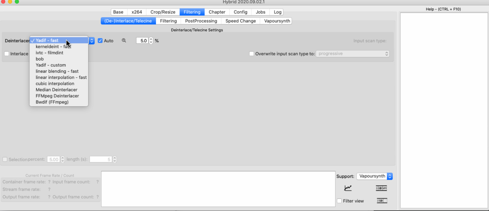

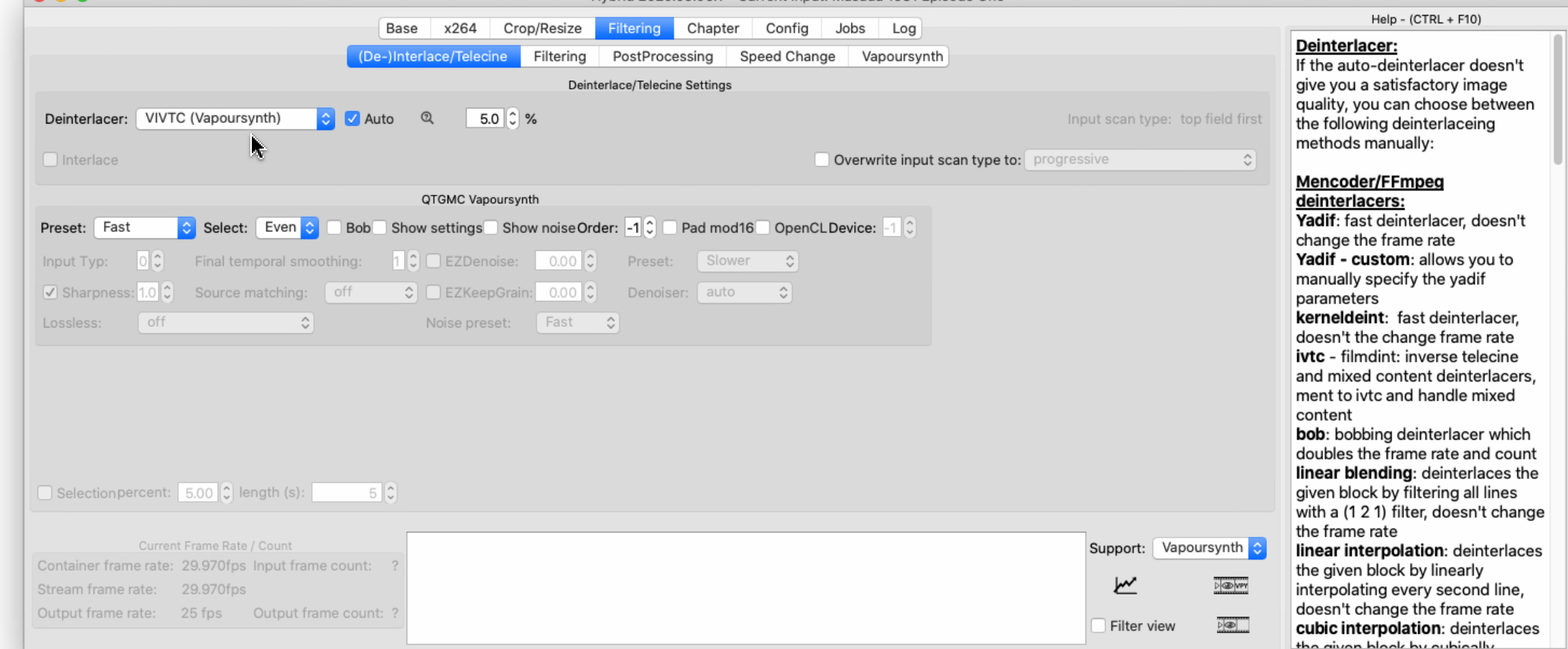

When i installed new version, i couldn’t find qtgmc under deinterlacer anymore.
Spoke to Selur who said. Make sure the Vapoursynth  Tab was selected and not no-xsynth. in the lower right hand corner. vapoursynth was selected, so i switched it to no-xsynth and then back to Vapoursynth and all the deinterlacers showed up.
I noticed the button next to qtgmc which on your most recent photo shows a button that says analyze. Mine still shows the old magnifying glass. So something is still wrong.
Also if i quit, and restart hybrid. It still shows vapoursynth profile selected in lower right hand corner. But same issue. All deinterlacers aren’t showing up. Have to switch to no-xsynth then back to vapoursynth.
I followed instructions to the letter.

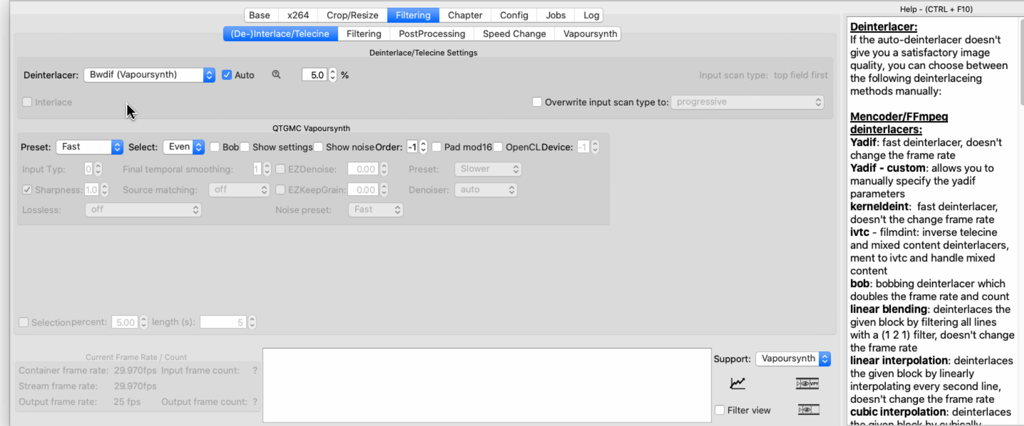

I was playing around in the deinterlacer setting
I selected tdeintmod turned on order 1 checked out the script to see what the options produce.
Then i went to qtgmc and again script to see what options i can produce In script
And now when i go back to the deinterlacer panel doesnt matter what deinterlacer i have the qtgmc options,
I have no any problems like this. Seems you just damage something somewhere and came to preferences conflict.
Try to uninstall Vapoursynth, Hybrid and Application support Hybrid folder, and do a clean install again.
