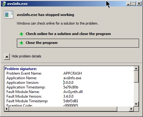

avsInfo.exe has stopped working
Continuing this conversation from July...
Every time I drop a .avs into the Open File, this appears.
I'm still using the 64+32 build from July, _dev_2020.07.28-212013.exe
I just have to close the error, and that's that. Nothing bad seems to happen, just annoying.
What else do you need to trace this, make it stop? Smile
Quote:Problem signature:
  Problem Event Name: APPCRASH
  Application Name: avsInfo.exe
  Application Version: 0.0.0.0
  Application Timestamp: 5e79c80b
  Fault Module Name: AviSynth.dll
  Fault Module Version: 3.4.0.0
  Fault Module Timestamp: 5dbf3d81
  Exception Code: c0000005
  Exception Offset: 0000000000084b56
  OS Version: 6.1.7601.2.1.0.256.1
  Locale ID: 1033
  Additional Information 1: 7e8e
  Additional Information 2: 7e8ecfdceb26d81eb1befd46d24f834b
  Additional Information 3: 8770
  Additional Information 4: 8770382a7be71118b0d4369bee05261f
Read our privacy statement online:
  http://go.microsoft.com/fwlink/?linkid=1...cid=0x0409
If the online privacy statement is not available, please read our privacy statement offline:
  C:\Windows\system32\en-US\erofflps.txt
Quote:What else do you need to trace this, make it stop?
a debug output to start off Smile

Strange thing is that avsInfo (64bit) version properly reports:
Color: YUY2, Resolution: 640x480, Frame rate: 60000/1001 fps, Length: 260114 frames, TFF
Audio:
Sample rate: 48000 Hz, Channel count: 2
and doesn't output an error.
-> I'll compile a current dev version for Windows and send you a link via PM.
atm. my guess is that this is either some problem with the old version or this is a problem with AviSource not liking the fast open and release of the source file.
No effect, still the same ... sort of.
The error is now instant. There used to be a lag of 2-3 seconds, between dragging AVS to input, and the pop-up error.
Using the 9/18 dev.
This issue aside, I see some other nice changes and additions in that new dev. Need time to play. Cool
Note that I write my scripts in AvsPmod, and generally test encode a trim() piece as AVI before commit to Hybrid encode. Not running into any Avisynth errors there.
Did you 'fix' the problems I mentioned, like:
a. loading the dependencies
b. adding 'return last' to the end of your script
Have you tried using FFVideoSource instead of AviSource. Problem with AviSource is that it uses VFW and thus I can't easily reproduce the problem here. Smile

as script Hybrid does open the file without problems here.
My guess is that the problem is due to a mix of Avisynth dlls or script versions being loaded between Hybrid and your auto-load Avisynth folder. (or an issue with AviSource or the vfw decoder)
Which is why Hybrids Avisynth scripts always start with 'ClearAutoloadDirs()' to avoid auto-loading.
Quote:Note that I write my scripts in AvsPmod, and generally test encode a trim() piece as AVI before commit to Hybrid encode. Not running into any Avisynth errors there.
Your AvsPmod is probably setup to use the system wide files in the Avisynth auto-load folder which whatever Avisynth version is installed in your system.
When loading it in Hybrid, Hybrid does not auto-load stuff.
