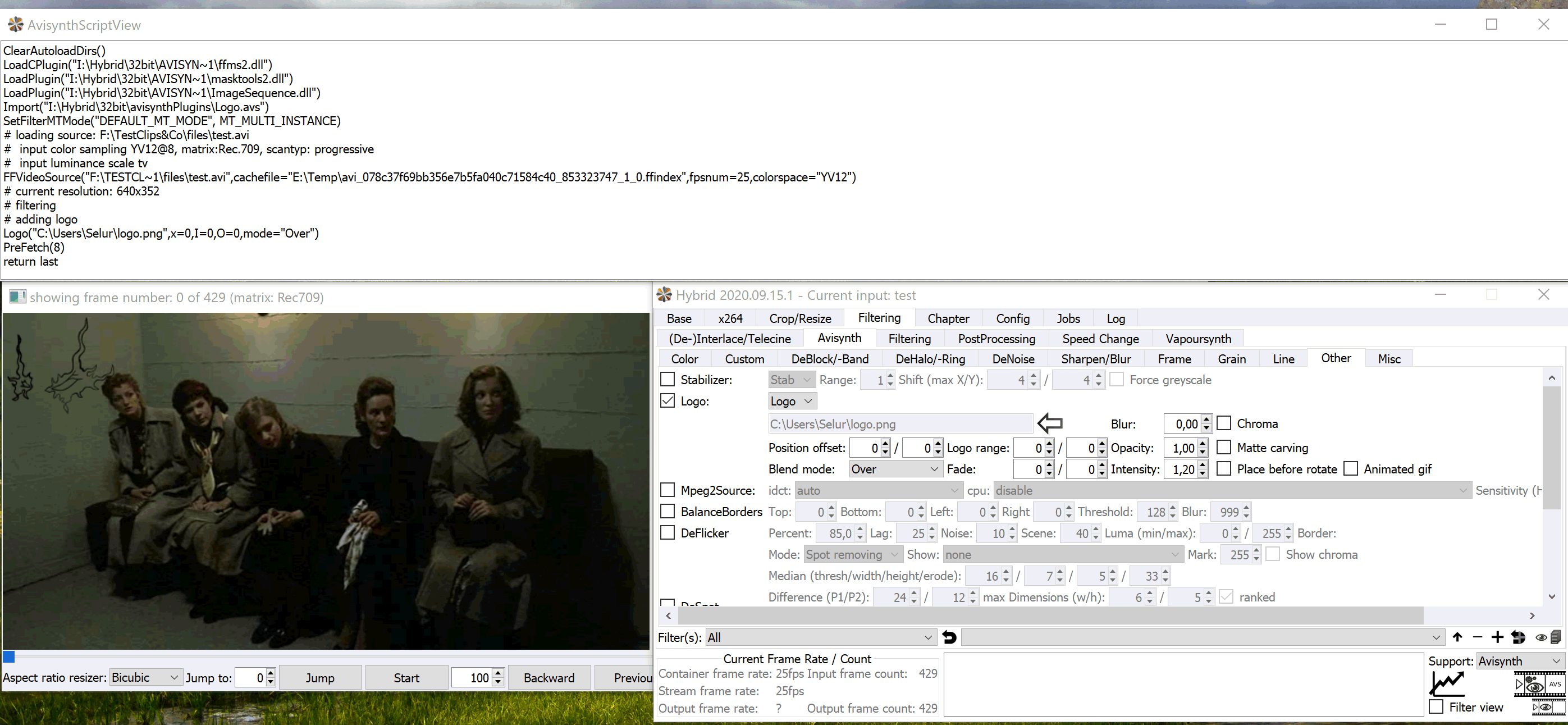

"Filtering->Avisynth->Other->Logo" seems to work fine here (see attached image)

With the base settings the logo does fade in the first 25 frames,...
Also check whether it does appear in the Avisynth Preview.

Works fine here. (see attached image)
-> Can you share the PNG you try to overlay?

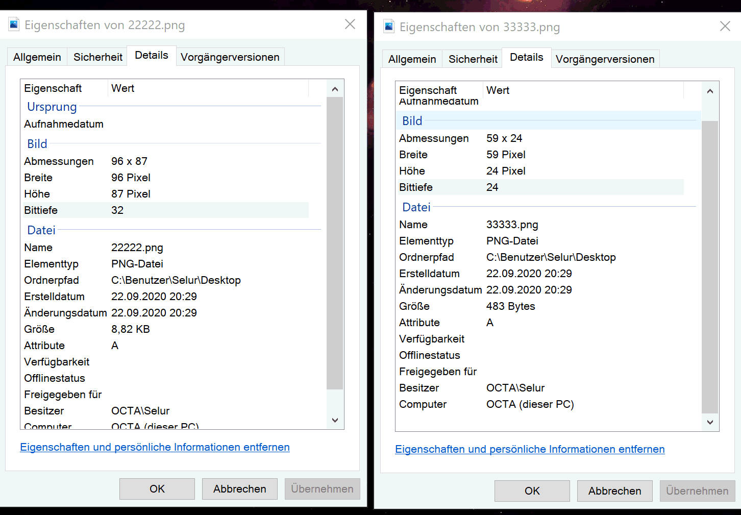

33333.png works fine here. (properly fading in over the first 25 frames and fading out over the last 25frames)
22222.png fails with:
Avisynth preview error: -> Import: unable to locate "����" (try specifying a path), error=0x2
only real difference I see is that the bit depth of 22222.png is reported as 32bit and the bit depth of 33333.png is reported as 24bit.
Opening the file in an image editor, saving it with a bit depth of 24bit instead of 32bit and the new file works with the filter.
-> seems like the filter does not support 32bit pngs
