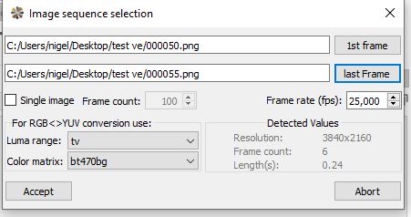

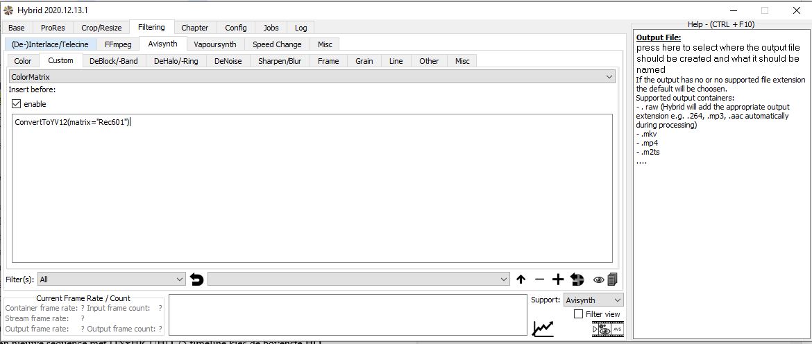

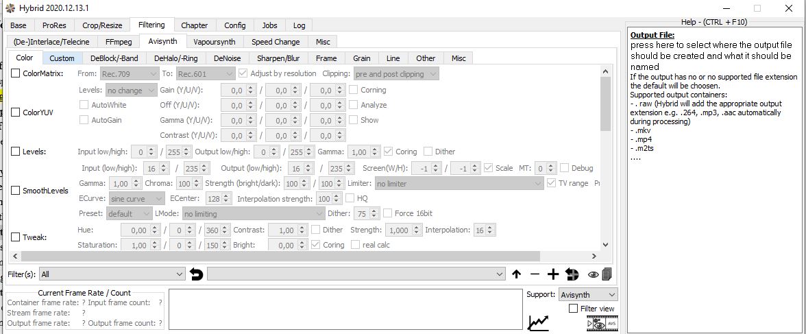

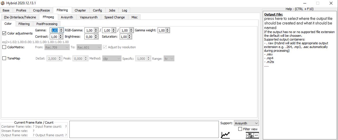

The Avisynth final result is very low in size and I can't play it with VLC. Do I need to install additional programs to make Avisynth (filters) work?
I tried this settings what am I doing wrong?
Quote:I tried this settings what am I doing wrong?
From your description before I would have used:
a. the ColorMatrix filter convert the color matrix
b. the Levels filter to adjust the gamma
c. configured ProRes to reflect the new color matrix in it's VUI settings.
Looking at your screenshots, I don't know why you are doing what you are doing.
  • You tell Hybrid the source is TV Range and bt470bg should be used as color matrix. -> Okay.
  • You use FFmpeg color adjustments to change the gamma. -> No clue why?
    I would not start mixing FFmpeg and Avisynth/Vapoursynth processing unless I'm totally sure that it makes sense and does what I indent it to do.
  • You change the color space in a custom addition in an Avisynth script, but you are not letting Hybrid know what you did. (This seems strange, especially since bt470bg and rec601 are basically the same so I would have suspected that this would not change much.)
Assuming your ProRes settings reflect the color matrix change, I would have suspected that the only thing that changed it the color sampling and the gamma, but no other color change.
I have no clue what the logic is behind what you are doing, but I dare not to doubt you, since you directly used the custom part to add custom additions to the generated Avisynth script. I assume you verified your changed using the script view and Avisynth preview.
So assuming the script and the script output look the way you intended, you configured the ProRes encoding properly Hybrid should abide by those settings.

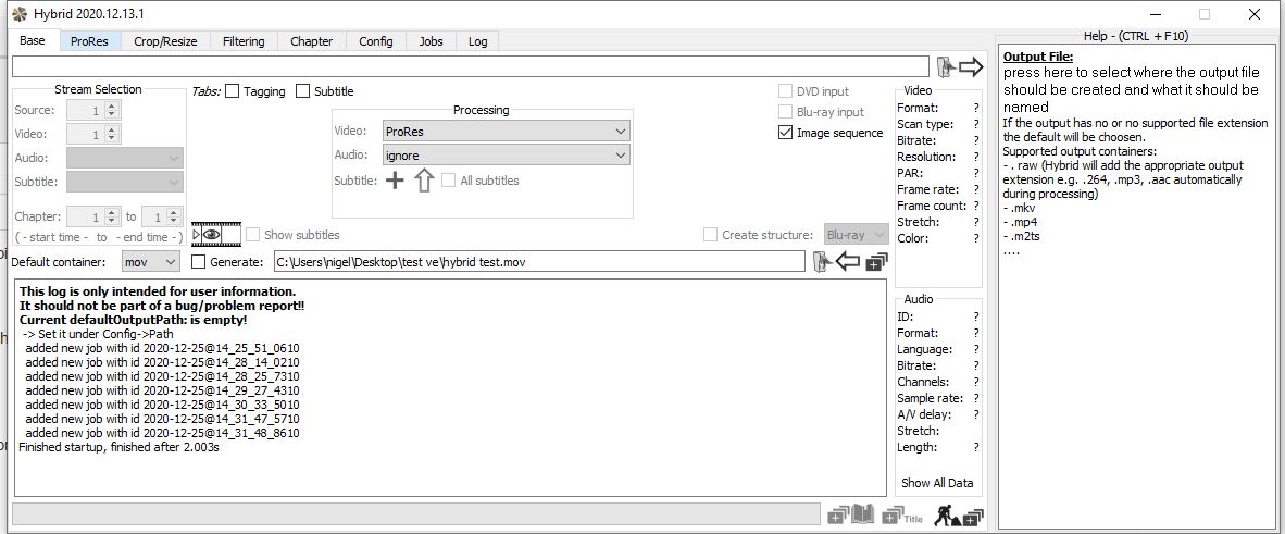

When I tried to export this error popped up
  p, li { white-space: pre-wrap; }
-> 2020-12-26@14_08_53_8910_02_video crashed: ERROR: C:\Users\nigel\Desktop\test ve\test v2_2020-12-26@14_08_53_8910_02.mov was not created!
Aborting '2020-12-26@14_08_53_8910_02_video' due to: ERROR: C:\Users\nigel\Desktop\test ve\test v2_2020-12-26@14_08_53_8910_02.mov was not created!
What does ERROR C mean exactly?
That error means that the expected output of a video encoding or extraction job wasn't created, no clue why since I have no idea what's happening.
-> Read [INFO] Infos needed to fix&reproduce bugs,.. and provide me with a proper debug output and I might be able to give you more details about what is going wrong.
