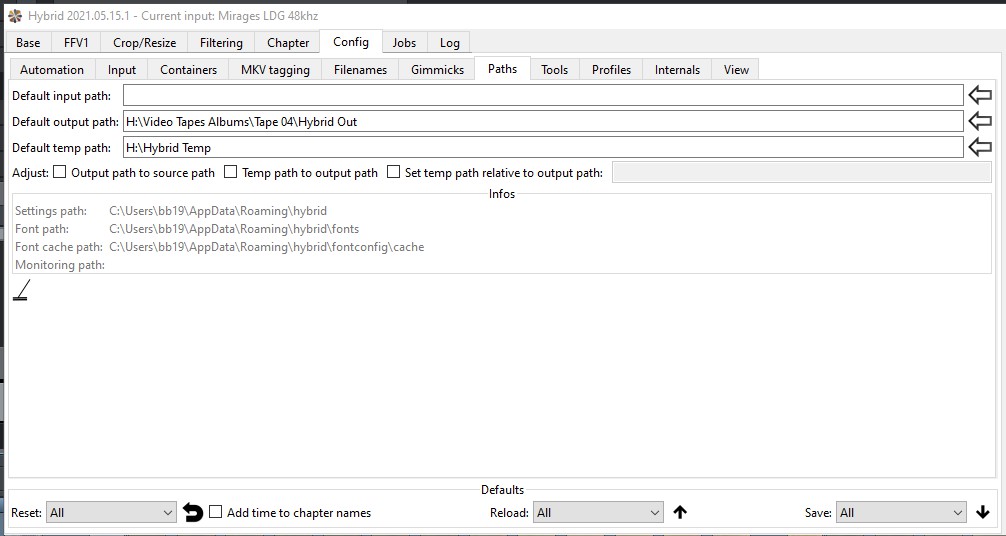

I've started using Batch processing and it looks great! I haven't used the three "Passthrough" steps as I'm processing AVIs with QTGMC.
I've noticed that the new files seem to end up in the parent directory, not the directory I set in the Default Output Path. In the attachment, the files are ending up in H:\Video Tapes Albums\Tape 04. How do I get the new files to go into the Output folder?
Also, I couldn't see anywhere to set "Base>Add to Queue" and "Jobs>Queue>Start". I just went ahead and hit the Go button on the Base page (the wheelbarrow man) and both files where processed OK.
Thanks again for a great program, Selur.
No debug output. -> no clue, works fine here.
(-> read sticky)
(assuming you did followed the order in the list, the default output should be set, properly and used in the queue. Personally I first set Default output&temp path and save them as defaults and usually restart Hybrid)
Will look at the debug output after work (in ~13hrs) if you provide one.
"Base>Add to Queue"
in Base Tab right next to where you can set the output. (read the sticky)
"Jobs>Queue>Start".
'Play'-Button in the 'Queue'-subtab ob the 'Jobs'-tab
