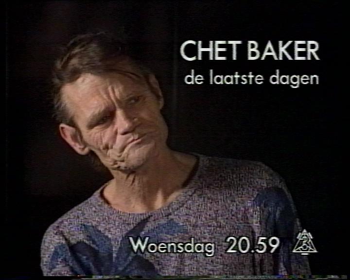

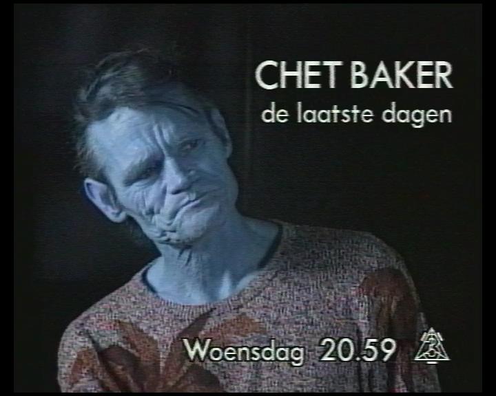

Enabling FFmpeg 'color adjustment' messes up the colors when encoding 4:2:2 video to x264 with color space 'i442'. To reproduce using 2021.04.12.1 :
  • input 4:2:2 video
  • enable FFmpeg 'color adjustment' (no need to adjust parameters)
  • x264
    • color space: i422 => wrong colors
    • color space: i420 => right colors
Interestingly the filter preview works fine and shows the effect of adjusted color parameters. Attached is a frame from the original 4:2:2 video and the corresponding frame in the encoded x264 in i422 (no other filtering is applied, only cropping + letterbox).

I can reproduce the issue.
Happens since the color adjustment is implemented through mencoder (not ffmpeg), no clue how to fix it atm. but I'll look into it.
Will add an ugly workaround by adding 'swapuv' when this is used.
