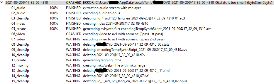

Hello guys! I need your help.
I tried encode MPEG-2 (DVD) to AV1 (Aomedia, aomenc encoder), but I got crashed and it says too small size 0 kb, here is what I got log:
p, li { white-space: pre-wrap; }
-> 2021-09-20@17_32_09_4310_06_video crashed: ERROR: C:\Users\User\AppData\Local\Temp\DVD_2021-09-20@17_32_09_4310_06.stats is too small! (byteSize: 0byte)
Aborting '2021-09-20@17_32_09_4310_06_video' due to: ERROR: C:\Users\User\AppData\Local\Temp\DVD_2021-09-20@17_32_09_4310_06.stats is too small! (byteSize: 0byte)
Others encoders like x264 and x265 that might work.
Is there any solutions how to fix too small?

Okay, so I just deleted DGIndex.ini, but I couldn't find DGDecNV.ini and dvd to aomenc got crashed. I followed your instruction that I deleted Hybrid/32bit/avisynthPlugins, there was only one DGIndex.ini and also same as Hybrid/64bit/avisynthPlugins/, so there was no DGDecNV.ini in 32 bit and 64 bit folder. I got same error as INI file is invalid. So here is again debug file another: https://ln5.sync.com/dl/562d06190/teje79...m-dh9qvavd

3. The encoding call:
"C:\Program Files\Hybrid\32bit\ffmpeg.exe" -y -loglevel fatal -noautorotate -nostdin -threads 8 -i "C:\Users\marti\AppData\Local\Temp\encodingTempSynthSkript_2021-09-21@08_38_07_0510.avs" -an -sn -vf zscale=rangein=tv:range=tv -pix_fmt yuv420p10le -strict -1 -vsync 0 -f yuv4mpegpipe - | "C:\Program Files\Hybrid\64bit\aomenc.exe" --passes=2 --pass=1 --target-bitrate=1500 --end-usage=vbr --fpf="C:\Users\marti\AppData\Local\Temp\HUNTDVD1_2021-09-21@08_38_07_0510_06.stats" --min-cr=36 --profile=0 --cpu-used=3 --min-q=36 --max-q=63 --bias-pct=100 --minsection-pct=15 --maxsection-pct=10000 --lag-in-frames=25 --drop-frame=0 --undershoot-pct=0 --overshoot-pct=0 --buf-sz=6 --buf-initial-sz=4 --buf-optimal-sz=5 --drop-frame=0 --kf-min-dist=0 --kf-max-dist=250 --auto-alt-ref=1 --arnr-maxframes=7 --arnr-strength=5 --noise-sensitivity=0 --denoise-noise-level=0 --sharpness=0 --static-thresh=0 --tune-content=default --tile-columns=0 --tile-rows=0 --frame-boost=0 --aq-mode=2 --min-gf-interval=0 --max-gf-interval=2 --threads=16 --width=696 --height=576 --input-bit-depth=10 --bit-depth=10 --denoise-noise-level=0 --min-partition-size=4 --max-partition-size=128 --row-mt=0 --good --sb-size=0 --max-reference-frames=7 --disable-trellis-quant=0 --enable-tpl-model=1 --enable-keyframe-filtering=0 --force-video-mode=1 --reduced-tx-type-set=1 --use-intra-dct-only=0 --use-inter-dct-only=0 --use-intra-default-tx-only=0 --quant-b-adapt=1 --coeff-cost-upd-freq=0 --mode-cost-upd-freq=0 --mv-cost-upd-freq=0 -o NUL -
fails with "Fatal: Failed to open statistics store"
Does it show any additional errors when calling this call inside a Windows Command Prompt?
