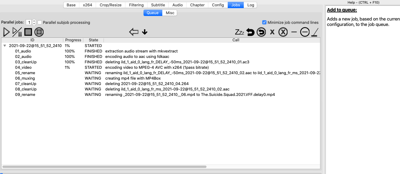

The procedure I followed is just above :
  1. I launch Hybrid
  2. I drap/dropped the new sample source file in the Base field
  3. I turned to Custom for the audio

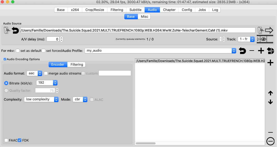

  4. In Audio : I saw that the Fr audio has a 1000 delay and and the second track (en) has 0 delay
  5. I reload my parameters for encoding the audio (->Apply the currently selected profile)
  6. The audio 1st track is selected (Fr) : I put 0 as delay A/V; then I hit the return key (to be sure the 0 is taken)
  7. I added the track for encoding (I click on the + : -> Add current)
  8. I returned to the Base and add a name for the video output : -> Set Output File
  9. Base / Add to queue
  10. Jobs : Start
Here is a copy/past of the just after putting a 0 delay for the audio track : (point 4)
/Users/Famille/Downloads/The.Suicide.Squad.2021.MULTi.TRUEFRENCH.1080p.WEB.H264.WwW.ZoNe-TelecharGement.CaM (1) (2)-001.mkv;0;aac;6;bitrate;192;FDK;low complexity;48000;3.00;fr;-50;87.104;ac3;0;1;toStereo (dpl2);;false;;false;2;false;;;;false;false;;;false;48000;1;ac-3;;false;true;false;3/2/0.1;1/1;;0;0;;None;54:_:15;10;20;0;1000;;false;;pcm;false;2;;;;;;16;-n;4;GPU;NVIDIA CUDA;;6;false;/Users/Famille/Downloads/The.Suicide.Squad.2021.MULTi.TRUEFRENCH.1080p.WEB.H264.WwW.ZoNe-TelecharGement.CaM (1) (2)-001.mkv;true;false;;;false;2;;;-1;
Here is a copy/past of the MP4Box, after the encoding, so at the end :
I disabled "Jobs->Queue->Minimize job command lines" to look at the created job calls, and especially to the MP4Box call :
MP4Box -add "/Users/Famille/Films-Apple/2021-09-25@16_40_24_6910_04.264"#video:fps=24000/1001:delay=50:name="":lang="" -brand avc1 -add "/Users/Famille/Films-Apple/iId_2_aid_0_lang_fr_ms_2021-09-25@16_40_24_6910_02.aac"#audio:name="":lang="fr" -mpeg4 -itags tool="Hybrid 2021.09.24.1" -tmp "/Users/Famille/Films-Apple" -new "/Users/Famille/Films-Apple/_2021-09-25@16_40_24_6910__06.mp4"
See the result file around 1min 20 s. No sync between the audio track and the video... There is exactly 1s delay. See that with either VLC nor SMplayer.

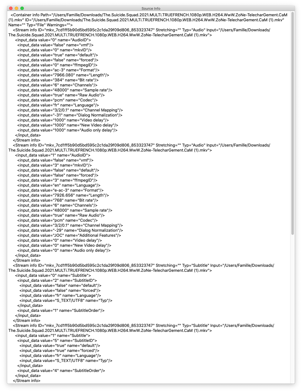

Just to be sure I get this right:
  • You have a source file that indicates:
    - a delay of 1000ms for the first audio track
    - a delay of 0ms for the second audio track
    according to MediaInfo.
  • You reencode the file with the first audiotrack with a delay of 0ms and the video is sync.
    Hybrid properly used that delay, adjusted by the encoder delay, in it's calls.
  • You reencode the file with the first audiotrack with the originally indicated delay of 1000ms and the video is sync.
So independent of the delay you get a sync file?  Huh  That seems strange.
I tested this here and for me if I change the delay, the output audio gets delayed properly.
Played the files using VLC and MPC-HC.
If I reencode the first audio track while adjusting the delay to 0ms the output is async, only If I stick with the 1000ms delay the audio is sync.
I have no explaination for that behaviour, assuming the MediaPlayer used doesn't ignore the delay if it's greater as xy ms. (Hybrid does ignore delays which are greater than 5000ms or smaller thatn -5000ms.)
If you look at the encoded files with MediaInfo (or load them in Hybrid) what audio delays are reported?

To sum up what I did, and I observed :
(with the whole source file -Suicide Squad - , or the second sample I gave you ):
- I reencode the video + Audio track Fr with 0 delay : video not sync
- I reencode the video + Audio track fr with any delay you want : video not sync
These are results for the 1st audio track (fr). (I didn't play with the 2nd track but I guess if there is no delay in the metadata, no problem will occur and the video/audio will be sync)
it due to the fact that in the metada (data visible with MediaInfo), there is a 1000ms delay in the source mkv file. But in fact, there is no delay if you play the mkv file directly with vlc or smplayer. I mean, the metadata in this source file is not correctly set. And whatever you put in the frontend for the delay, the output file will not be sync.

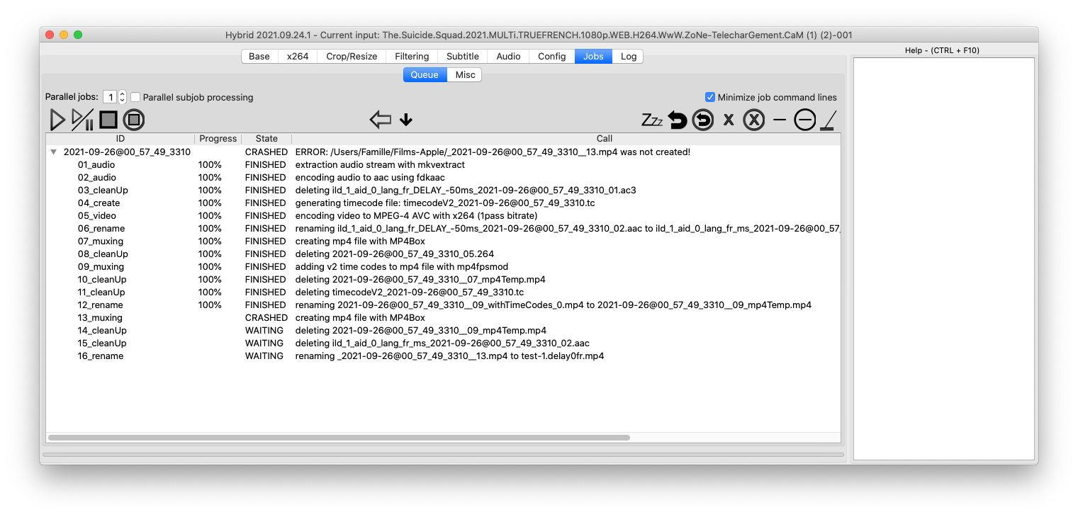

Enable "Config->Automation->On Load->Always extact time codes from input" before loading the source like I told you before.
At least for me that fixes the problem.

Okay, issue seems to be related to the mp4 muxing. (independent whether ffmpeg or mp4box is used as muxer)
If I use mkv instead of mp4 as output container everything works correctly. <- can you confirm this on your system?
Ps.: going to bed now will play with it some more tomorrow.
couldn't sleep and created an entry in the MP4Box issue tracker may be the MP4Box developers can shed some light on this.

Another test : I reencoded the second sample, with the  Config->Automation->On Load->Always extract time codes from input enabled, Hybrid crashed (see the screen capture). If I reencode the second sample as a mkv output file (mkv container at the end), this sample is not sync ...
Reencoding another source file (with 0 delay as metadata therein, visible by MediaInfo), with a delay forced at 1000ms, the output mkv file is not sync ! So the delay put in the frontend works sometimes, or works in principles, except with the 1st source file ...
