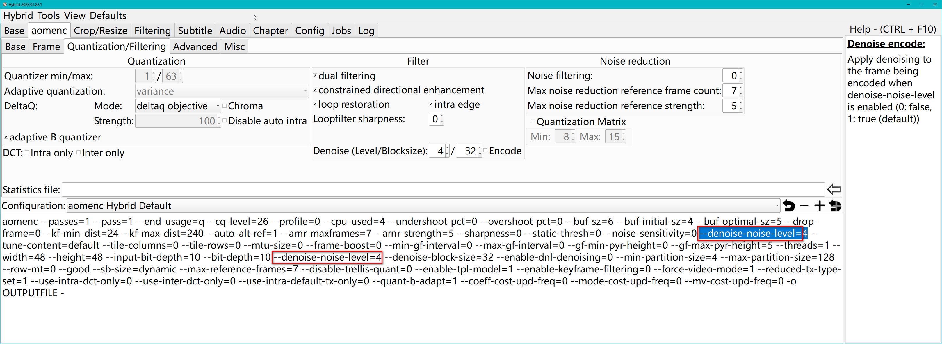

There are two
--denoise-noise-level=
#42
Hybrid already supports
--denoise-noise-level=..
--denoise-block-size=...
--enable-dnl-denoising=...
under "aomenc->Quantization/Filtering->Filter" in the dev version.
#43
cmd parameter line repetition
#44
I will fix that.
=> send you link via pm
