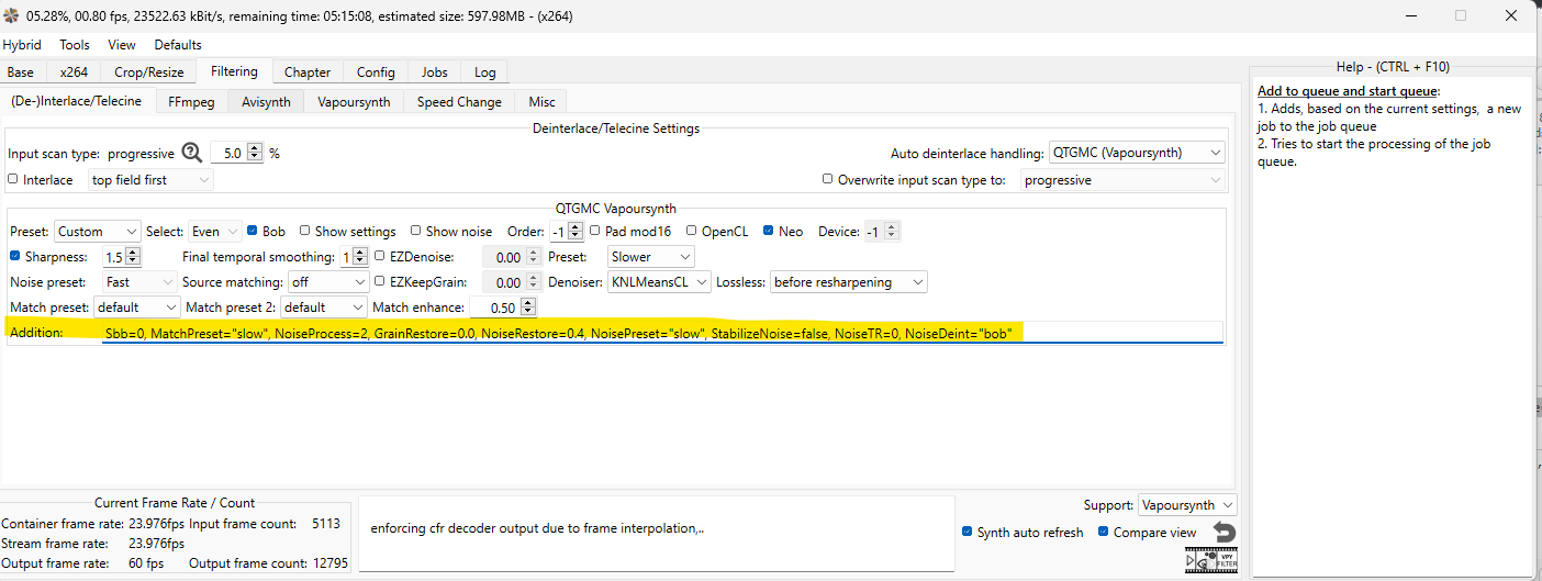

Also can you please check the screenshot that is this way to add additional settings into QTGMC?
There are a few things wrong.
a. those are parameters for Avisynth QTGMC, in Vapoursynth 'True' and 'False' are used, not 'true' and 'false'.
b. since the 'Addition'-text is directly added to the script you need to start with a comma ','. => look at the script view
Side node: if you want to see all the current setting of QTGMC, enable 'Show settings'.
Here's a screenshot of what it looks like with 'Show settings' enabled and having the Vapoursynth Script View and the Vapoursynth Preview open.
(14.10.2023, 18:50)Selur Wrote: There are a few things wrong.
