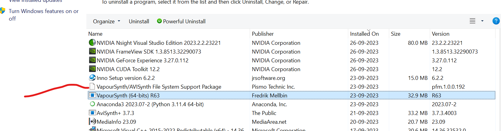

Could you please guide how to identify the system wide installation of Vapoursynth so i can remove that one from my machine.
IS this you are mentioning about the Vapoursynth system wide?
#12
If "Start > Settings > Apps" lists Vapoursynth uninstall it.
#13
Hi Selur, I have removed those two Vapoursynth from my machine as i shown in below screenshot.Please Confirm for the same.
Now do i need to re-install hybrid dev with vapoursynth?
#14
Yes, that is an old Vapoursynth release, that could cause problems. (Especially since it's R63 and a lot of changes happened in Vapoursynth with R64 and Hybrid dev uses current R65)
Can't say anything about the 'Vapoursynth/AVISynth File System Support Package'.
