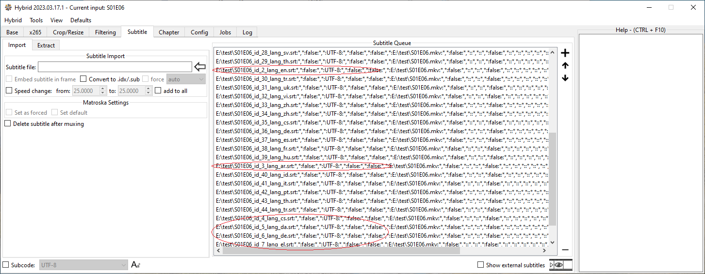

Subtitle Queue Add Subtitle ID 2 After ID 29
And Subtitle ID 3 After ID 39
And Subtitle ID 4, 5, 6, 7, 8 & 9 After ID 3x
That is the problem.
There is no problem with the number of subtitles below 10. But after 10, it runs into problems.
