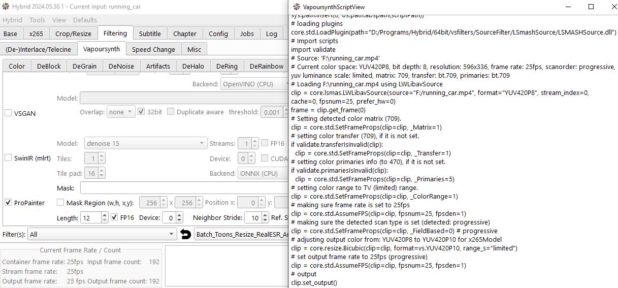

vsProPainter is listed as available, but no code using it is generated when is selected as filter in Filtering->Vapoursynth->Other
As you can see I selected ProPainter
[Image: attachment.php?aid=2515]
But is not generated any code when I create the encoding job.
I attached the full log.
In this screenshot is shown the script generated when I check ProPainter.
[Image: attachment.php?aid=2517]
ProPainter is not included in the generated script.
#42
You entered no Mask. => nothing to do.
ProPainter:
a. needs to be in the FilterOrder (Filtering->Vapoursynth->Misc->Filter Order/Queue)
b. it need to be enabled (Filtering->Vapoursynth->Other->ProPainter)
c. a Mask need to be set (Filtering->Vapoursynth->Other->ProPainter->Mask)
Since the Mask is essential and there is no default Mask or anything like that (same with for example, Other->AddLogog, Other->GLSL, Other->VSGAN) adding a not usable entry to the Script does not make sense.
