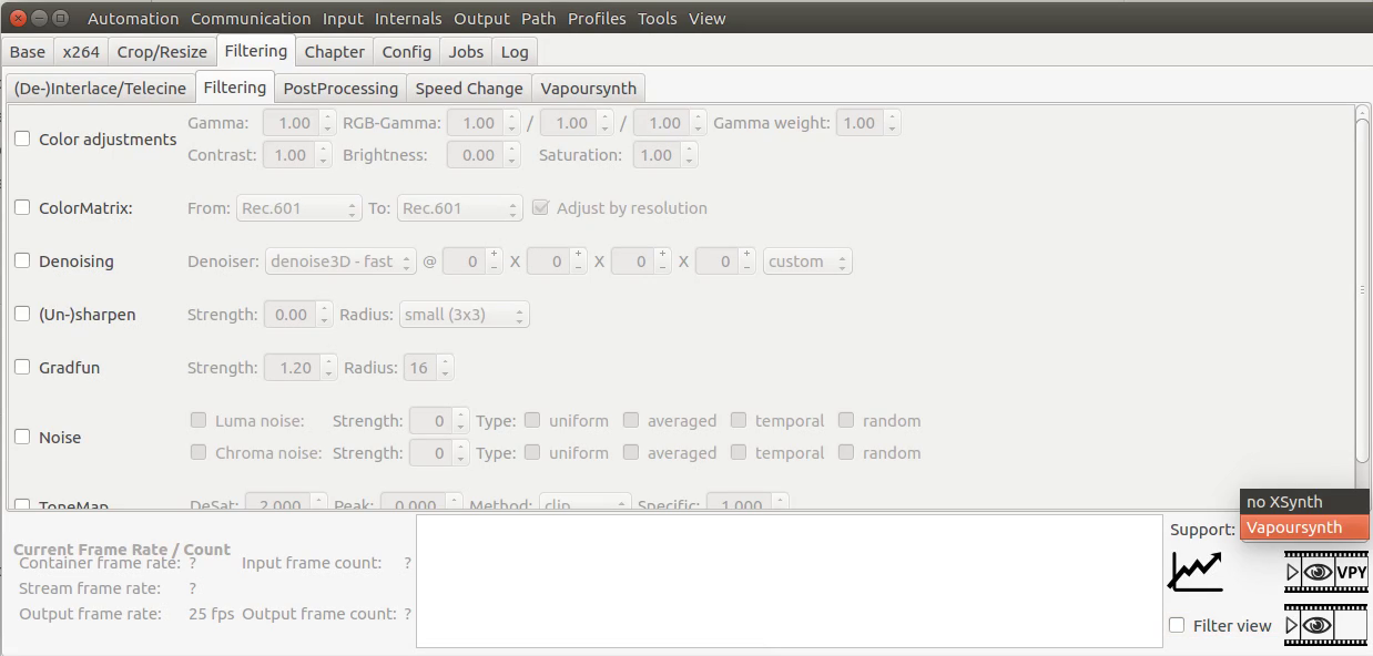

1. I am unable to use avisynth. It is as if it was never installed. (Please refer the screenshot in the attachments)
I'm guessing this has something to do with the non-windows avisynth extension on selur.de/downloads

Regarding Avisynth:
You'll have to wait for feedback from djcj dir that.

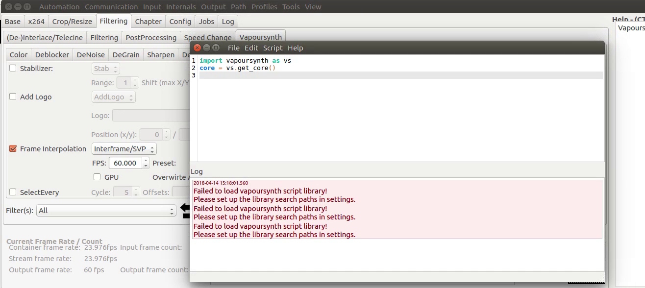

Vapoursynth preview does not work either. The error shown in VSedit is
                       'Failed to open the file --preview-only'
The log in VSedit read
                                        Failed to load vapoursynth script library!
                                        Please set up the library search paths in settings.
Do I need to have vapoursynth installed in advance before installing hybrid-vapoursynth-extension?
nope,...
What does the Vapoursynth script look like?
What is the path to vsedit?
Hybrid uses a modified vsedit version, which I probably (djcj?) should be in the hybrid-bin folder.
The normal vsedit, doesn't allow to be controlled through another program (here Hybrid).
It has two lines of code:
import vapoursynth as vs
core = vs.get_core()
I have attached a screenshot for the same too
That looks like the wrong vsedit is used, which doesn't load the generated script.
-> you will have to wait for djcj to look at this.
Vsedit needs to be from https://github.com/Selur/vapoursynth-editor
