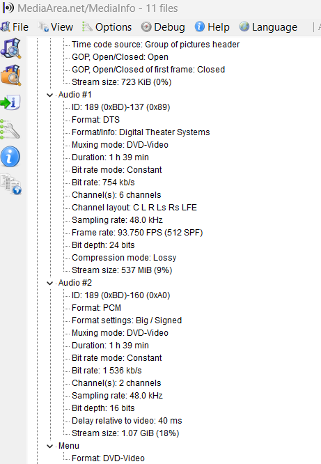

Hi. I seem to have an issue with reading DVD-Input and multiple audio-streams on the DVD.
For example, my DVD has 2 audio streams, the first stream is #139 and contains DTS 5.1 Audio.
The second stream is #160 and contains a LPCM audiostream.

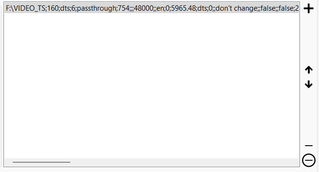

When I select "Audio: auto add all" in the Base tab, Hybrid adds 1 stream under Audio, containing 2 audio-streams in 1 line (so without Enter) :
F:\VIDEO_TS;160;dts;6;passthrough;754;;;48000;;en;0;5965.48;dts;0;;don't change;;false;;false;2;false;;;;false;false;;;false;48000;unknown;dts;;false;true;false;;1/1;;;;01;None;;;;;;24;;;;false;1;;;;;;;;;;;;6;false;F:\VIDEO_TS;true;false;;;;6;;;-1;; :*: F:\VIDEO_TS;137;dts;6;passthrough;754;;;48000;;en;0;5965.48;dts;1;;don't change;;false;;false;2;false;;;;false;false;;;false;48000;unknown;dts;;false;true;false;;1/1;;;;01;None;;;;;;24;;;;false;2;;;;;;;;;;;;6;false;F:\VIDEO_TS;true;false;;;;6;;;-1;;

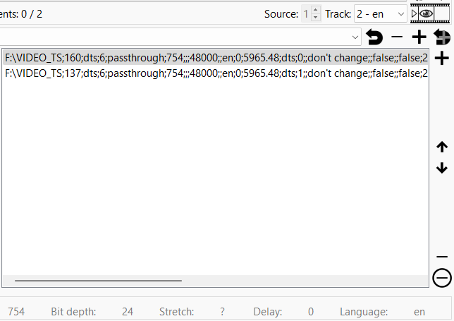

The strange thing is, that both streams are read as DTS, the audio-type of the 1st stream. This issue occurs also when deleting the entry above and add both tracks seperately:
I can reproduce this issue for 3 dvd's, so it look likes hybrid add the correct amount of audio-tracks, but copies the stream info of the first audio-track to all the tracks.

Media Info data:
