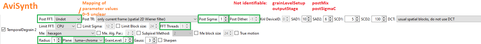

However, the parameter sets that are made available in the Hybrid GUI under (a) x264 > Filtering > Avisynth > Grain > TemporalDegrain 2 and (b) x264 > Filtering > Vapoursynth > DeGrain > TemporalDegrain2, are different from each other and do not correspond to those 11 parameters, as shown in these screenshots (green: parameter identified; red: parameter not identified).
I would need to access some of the parameters that are not included in this GUI. So here is my question: As a workaround, is it possible to specify the TemporalDegrain2 filter for Vapoursynth in Hybrid directly, i.e. by replacing the automatic call with in Hybrid with something like "TemporalDegrain2 (degrainTR=1, grainLevel=0, postFFT=1, postSigma=0, outputStage=1, postMix=25)"?

The Avisynth TemporalDegrain2 version that Hybrid uses has this signature:
function TemporalDegrain2 ( clip input, int "degrainTR", int "grainLevel", bool "grainLevelSetup", int "degrainPlane", int "postFFT", float "postSigma", int "postDither", int "fftThreads", int "postTR", int "postMix", int "postPlane", int "postBlkSz", int "meAlg", int "meAlgPar", int "meSubpel", int "meBlksz", bool "meTM", bool "meChroma", int "limitFFT", float "limitSigma", int "limitBlksz", int "devId", float "ppSAD1", float "ppSAD2", float "ppSCD1", int "thSCD2", int "DCT", float "gaussParam", bool "extraSharp", int "outputStage", bool "debug", bool "CUDA", string "dftsfile", int "postFFTc", float "postSigmaC", bool "degrainChromaTwoStep", bool "degrainAvoidChromaShift")
see: Hybrid/64bit/TemporalDegrain2.avsi on your system.
So all your options are present. Smile
Aside from
  • grainLevelSetup
  • postMix
  • postSigmaC
all are available in the gui.

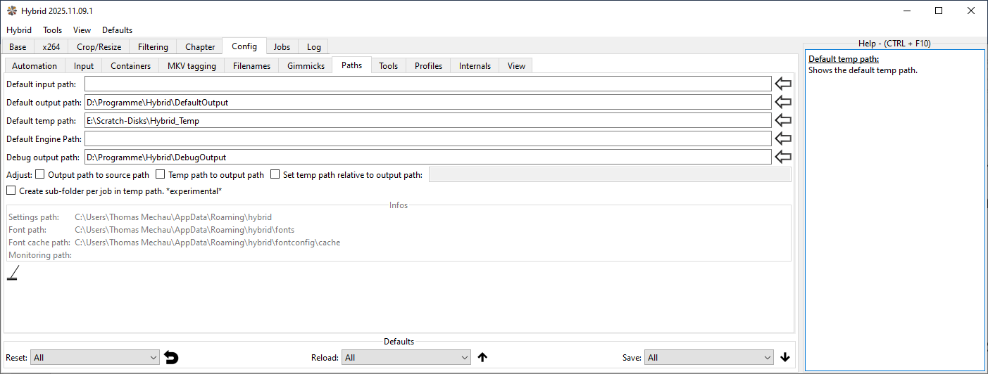

Actually there seems to be a real problem with my Hybrid installation or with Hybrid in general. I installed the program 3 or 4 times on different (non-C: ) drives and in different folders and specified all sorts of path names
but no matter what, after closing and re-starting Hybrid the result is always the same: All path settings are blank (so the user log complains that the "Default output" path is empty)
except for the "Default temp" path, which points to ...AppData\Local\Temp; and "Generate debug file" is unchecked. This means I can't permanently change the Temp folder.
(By the way, your instruction page about "infos needed to fix and reproduce bugs" is a little outdated (from 2017) and does not reflect that the Path settings now include a dedicated "Debug output path" in addition to the "Default output path" (for the video output?). But this does not matter so much because any path specified here will be reset after the next program start.)
Anyway – no matter what I try, specifying AviSynth reliably fails.

Quote:but no matter what, after closing and re-starting Hybrid the result is always the same: All path settings are blank (so the user log complains that the "Default output" path is empty)
You need to save the defaults for them to change.
reading [INFO] About profiles and saving settings,.... might help
