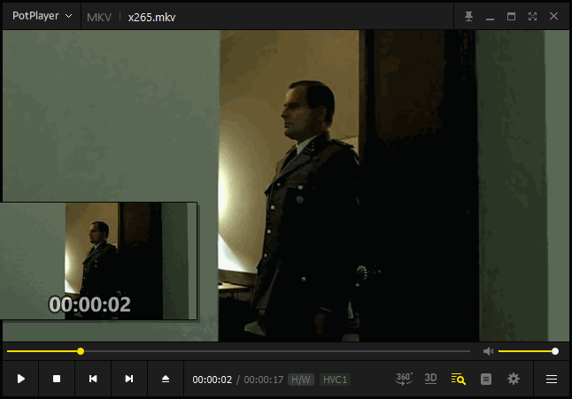

but encoded x265 file with Hybrid , can't see thumbnail in Potplayer, no isolate with win10. and other x265 video files are no problem
#20

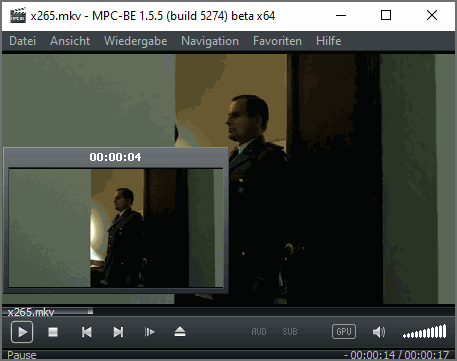

Quote:but encoded x265 file with Hybrid , can't see thumbnail in Potplayer, no isolate with win10. and other x265 video files are no problem
Works fine with MPC-BE and when I enable the preview for the slider.
I downloaded PotPlayerPortable_1.7.21212 and here the thumbnail preview on the slider works fine with mkv(H.265), for larger files it takes a while for the player to create the thumbnails but after a bit of waiting even with larger files theĀ  thumbnail preview on the slider works fine.
